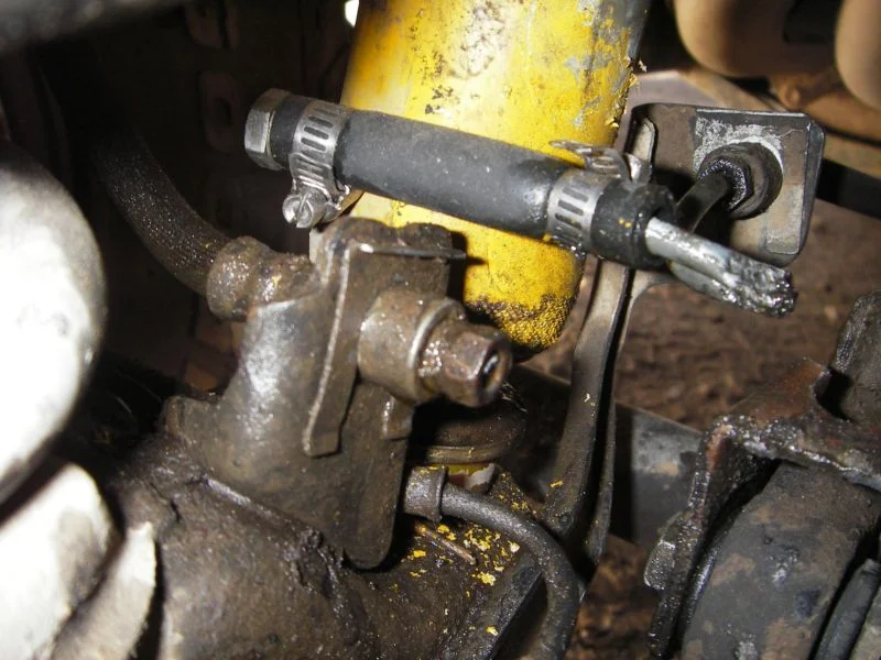

Pic one shows how I broke the metal brake line on the PS axle.
Has anyone ever done this, as I am not quite sure how it happened?
Looks like maybe the shock was hitting the mount and it just tore it out. Of course I have a complete set of extra flex lines on board but nothing like that.:rolleyes:
This presented a major problem as, like an idiot, I left my brake fluid at home after topping off, and the system was bleeding badly.
Well, we got the bleeding down to a small drip with a kink in the line and a piece of fuel line clamped down tight. Some guys on 4 wheelers said that, in a pinch, you can put water in the system instead of brake fluid but I really did not want to go that route as water can boil.

One of our guys broke that exact line at Rubithon last week. I'll bet your sway bar broke off the mount. When it does, It takes out that line. Look at the sway bar mount on the axle very carefully.
You can just make a new line-bad news there are not any available. We made a new line on the trail with a long piece of double male premade brake tube.

The right axle bracket of the front sway bar ripped off and as it did it took the brake line with it.

Brake fittings are probably 10mm. Can get premade lengths at any auto parts store. They are easy to bend, just be careful of kinking.
