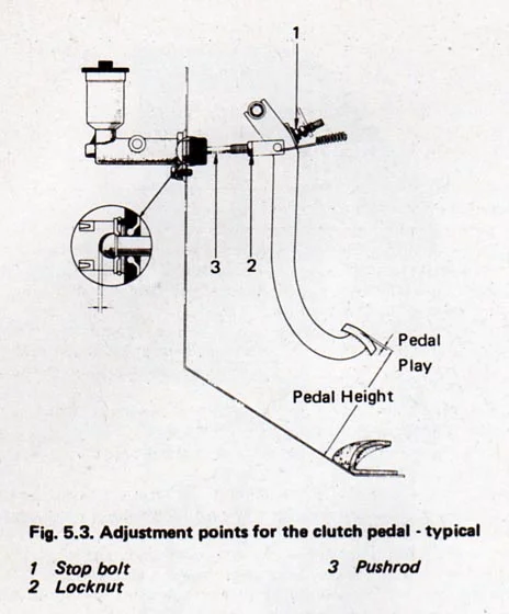

Can anyone measure the length of the clutch rod on a stock master cylinder setup? I'm trying to adjust the clutch, but it seems like i'm running out of adjustment while the pedal still has too much free play. I adjusted the slave cylinder, that part of it seems fine, it just seems like the clutch rod from the pedal to the master cylinder is too short. I've already adjusted it out all the way and still have about 2" of pedal play before the rod actually contacts the cylinder. Everything else is working fine, I'm not having any trouble shifting or anything, I just don't like the freeplay. Thanks

Hey thanks for the picture, those aren't the dimensions I'm looking for. What I was looking for was the length of the pushrod (#3 in the picture). Even with the rod adjusted out all the way, I can't get the freeplay within specs.
Bad master/slave cylinder(s)? :confused:
You might check you pedal placement is it even with the Brake peddle, you can adjust number 1 to make it closer.
