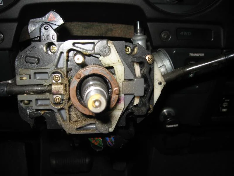

Followed the directios! Photos taken!
Thanks! This saved me several hundred dollars and worked perfectly. I took some pics while I did it and will toss them up in hopes they may aid others.
(1) Steering Wheel Off: you can see from this shot the reason this fix works - - lots of crud builds up in 20 years.

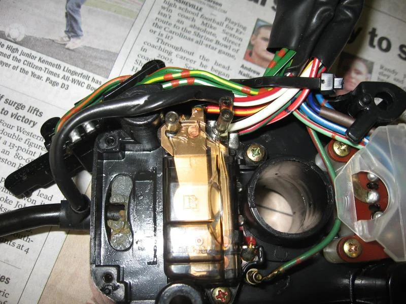

(2) The Dimmer Swith Module: here is the "culprit." Its the plastic covered switch with lots of copper inside. I followed the instructions and cleaned all contact points with 600 grit (no emery cloth in my shed). That cover is easy to pop once you remove the switch from the aray. In this shot, I have already taken out the hazard switch.
(3) The Inards: here is an extreme close up of the inner workings of the dimmer switch. Clean everything as instructed . . . let there be light!

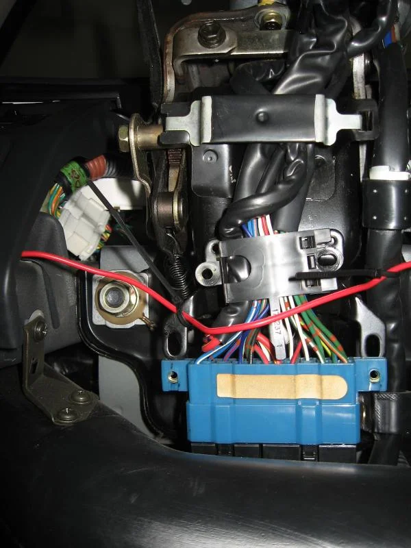

I have added one more pic that might help. This pic shows the wiring harness and the black strain reliever and blue plug which you drop by unscrewing. At the top of the pic is a black and white(silver) clip which you also undo. This comes out with pressure as it is spring loaded.
