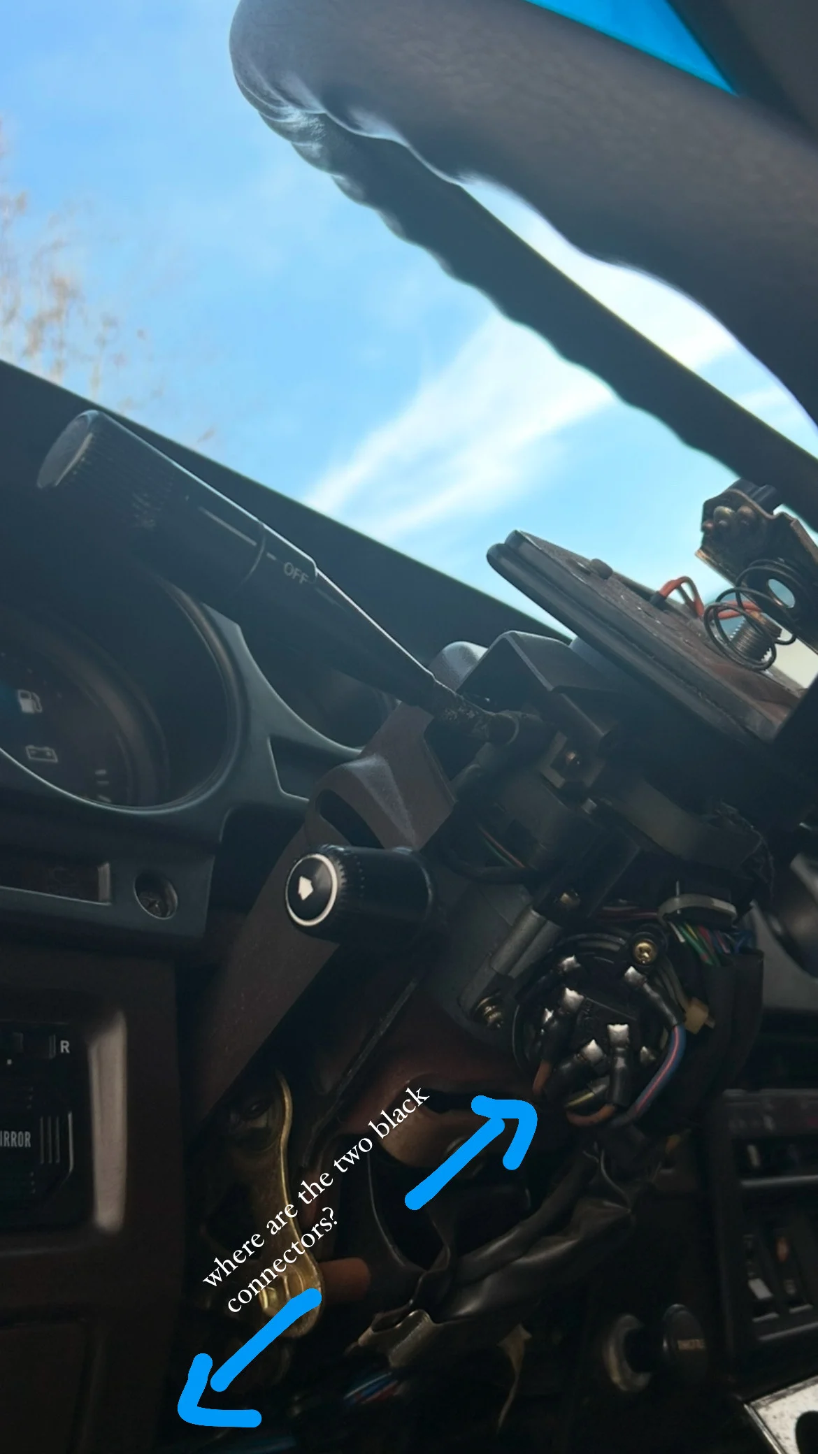

Hey folks! New here and just brought home my '89 FJ62 this past weekend. I'm chasing this problem and was wondering if anyone had pictures of where to find the black connectors in this step? Is it towards the steering column or deeper down? Working on the garage beer fridge once I baseline my FJ. Thanks all!
9. Disconnect the 2 smaller black connectors from the large blue terminal block and take the entire assembly over to a well lit workbench - preferably in close proximity to your garage beer fridge.
