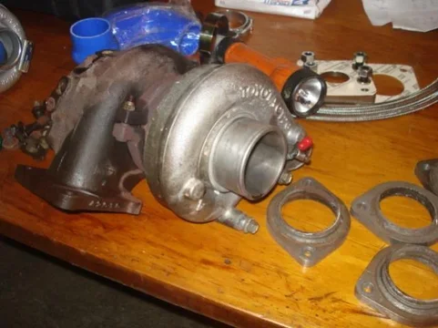

Before
CT26 off
Garret 2052

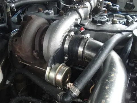

Exhaust bolted up and heat shield installed
Oil lines installed and silicone hoses going on ... Now we are getting somewhere!
finished!

Congrats and nice video. I see clearance to the firewall is tight. That is my biggest problem as I have my clutch and brake lines running there and my custom manifold leaves me with almost no clearance :confused:
Yeah its pretty tight! I think if I had anything bigger than a 2 1/2" exhaust back there it may have been a big problem!
What custom manifold are you using?
I used the 13BT which sticks out a ways from the firewall.
jfc I have everything that goes with the turbo that you see in the 1st pic.
Flange fitting to exhaust, flange gasket which is in really good shape, silicone hoses running over the block into the throttle body, pipe with threaded hole for the boost gauge, nuts, bolts, washers, clamps. Everything but the air cleaner, which as you can see I re-used :)
