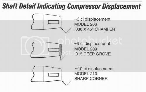

I can't help you with the numbers, but... if you can post a picture of the end of the crankshaft (with the clutch off) I can tell you what displacement it is.

The one you have pictured does not follow this rule....so I can tell you nothing about it. Also, tags are often missing or have been replaced if the unit was serviced... so they are NOT the definitive tool for identification (The shaft is).

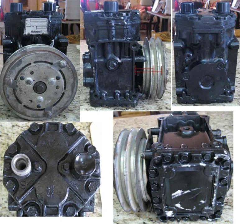

I guess I need to hold up until I get it and pull the clutch. Here is a set of pics:

Your Dad did an excellent job with the pics!
Looks like a 210 (10 cu. in) judging by the case. It has what appears to be a 7" pulley instead of the more common 6" (no problem though). It looks like the clutch/pulley has the most common "offset" too, so I'd say you're "good to go".
