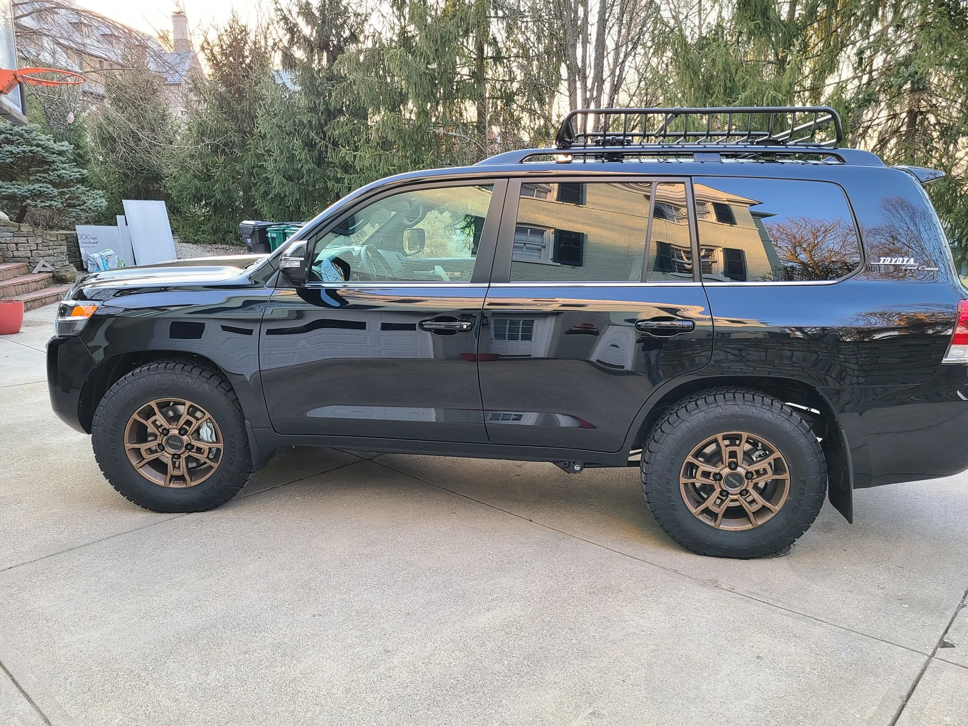

I am running 275/70/18 Toyo AT3 on stock HE wheels completley stock setup otherwise. They handle shockingly well on pavement in snow and wet so I think you could get away with running them year round but I have had blizzaks before and there are few tires better in snow than a blizzak. My use case is similar to yours and I could not be happier. These are E-rated and some might find this a harsher ride but to me it is firmer and a ride that I prefer. Bone stock, I ran this setup without wheel spacers and had zero rubbing or modification required.
I have since added 1.25 inch spidertrax spacers. Mostly for cosmetic reasons but I also feel that it helped reduce some harsh wobble I was getting when cornering on bumpy roads. The addition of spacers did require removal of the front air dam square as well as mud flap removal with some additional heat gun shaping and trimming on the inner fender liner but nothing too crazy. The truck with the spacers looks phenomenal and performs better than without with this particular tire size in my opinion.

@foolforthecity Any pics?

I just picked up an ‘18 LC and I’m looking at a very similar setup for wheels and tires, minus the spacers at this point. Definitely would be interested in pics. Also, curious if you noticed much difference in you mpg changing?
Photos as requested. Pic 1 is with no wheel spacers. Pic 2 with 1.25 inch spidertrax. These are Toyo AT3 275.70.18 at 41 psi. On mpg I can't really comment as it is not something I care about and I only ran the dunlops for 120 miles.

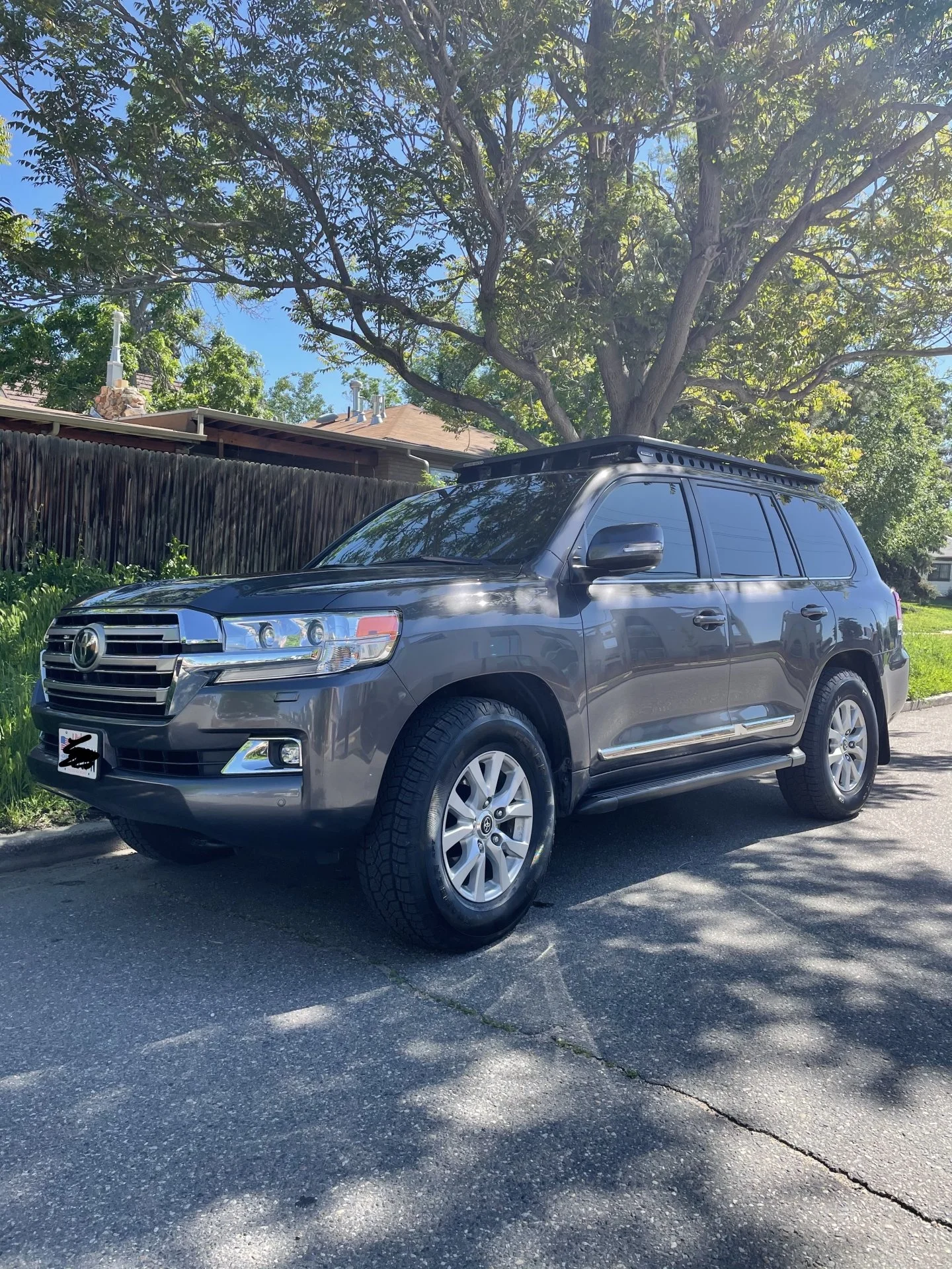

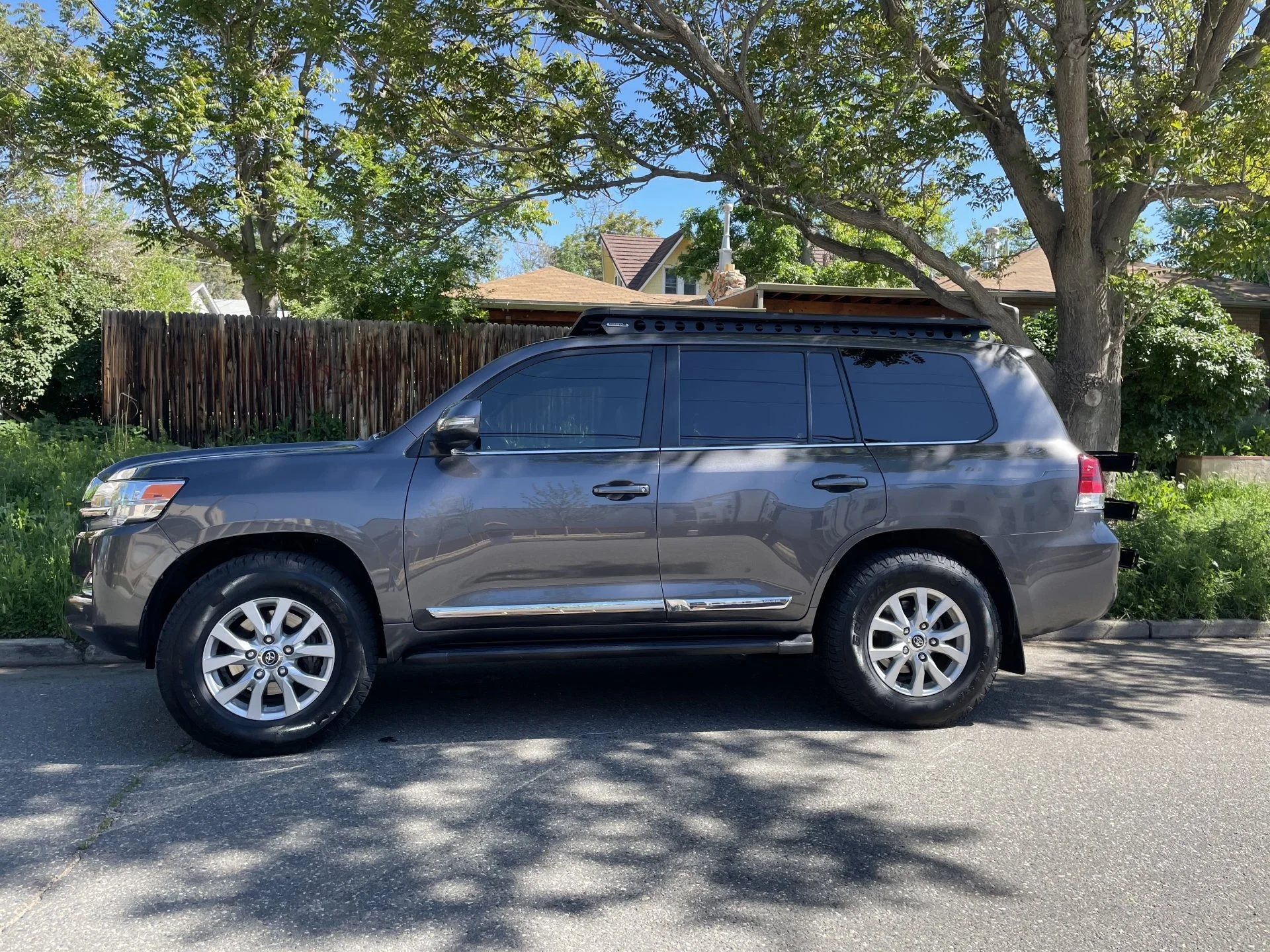

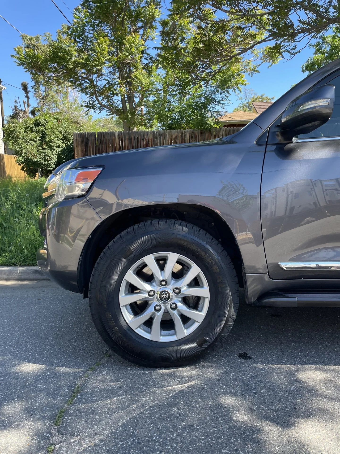

As requested, here is my feedback on these General Grabber APT P275/70R-18 on a mostly stock 2017 LC200.
Ride: These seem to be very quiet, maybe slightly louder than the stock Dunlops or my Blizzak snows, but after 2 miles I don't notice the difference. Ride is slightly firmer, although not in a bad way. Cornering is better and the car seems to drive "tighter", although when hitting potholes/bumps the impact is a little harsher. Overall, very happy with the ride and I'm sure they are good off-road also for a p-rated tire.
Look/Fit: I've attached some pictures here. The 70 size definitely fills the wheel well, although I do miss the width of the 285s. The tread looks pretty aggressive, but not full off-road (there is a lot of smooth sidewall to look at before the tread starts).
I have 1.25in spidertrax spacers so rubbing issues are probably due to these. I got some rub at lock in the front but this went away after removing the mud guards, which I don't miss. The tires still rub at lock in reverse, but don't seem to be causing any damage, just an unpleasant noise

View attachment 2703026View attachment 2703027View attachment 2703025
Your truck looks great. I’m surprised at the rubbing, but prior reports noted these are taller for the sme spec vs BF Goodrich and Michelin. Please keep us informed on how you like them as the miles pile up
