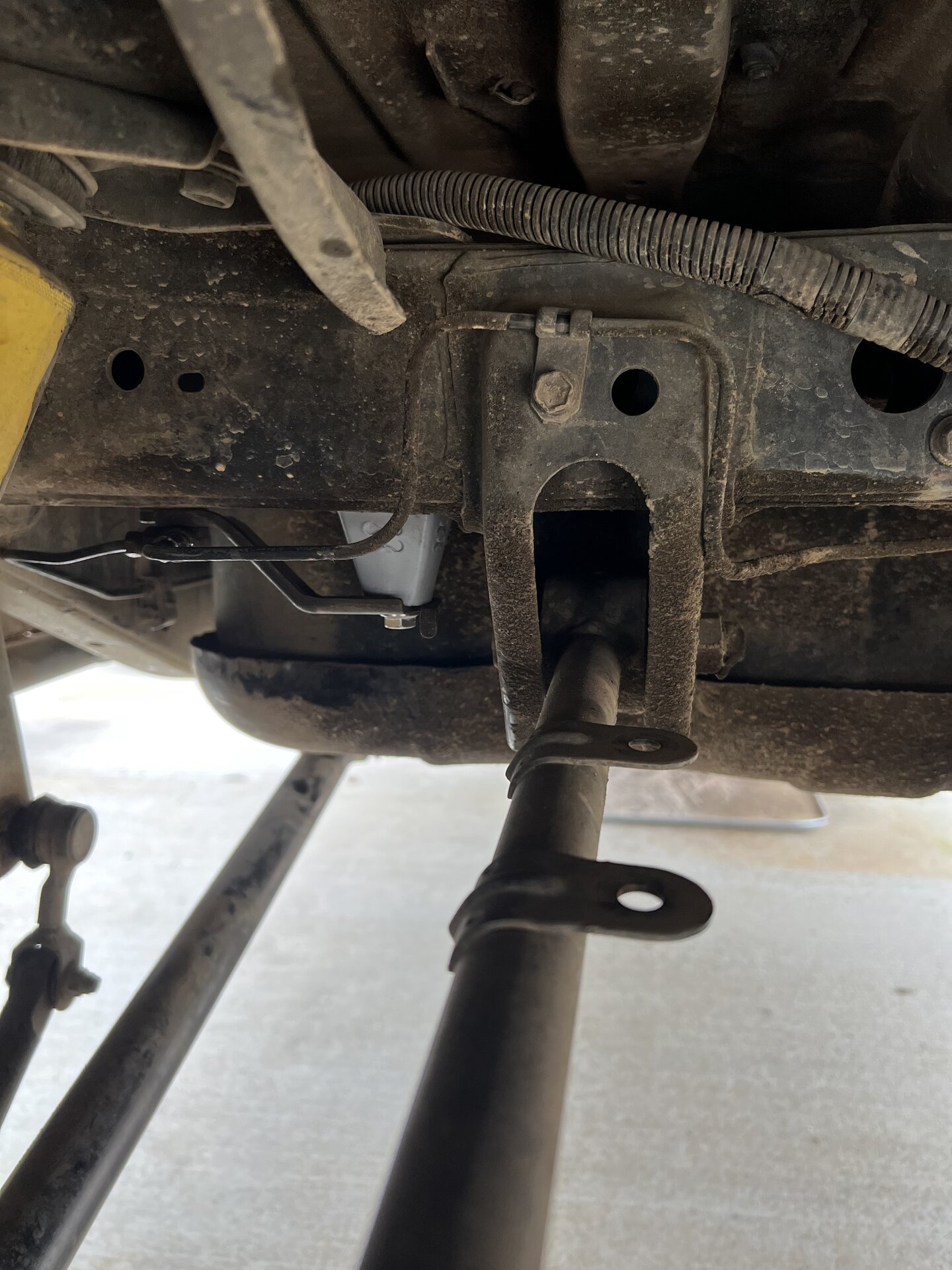

I tried to keep the rear 90° elbow bracket intact but, It just wasn't worth the effort of having to monkey with the two lines. I think my solution is nice and easy while being very clean. This part of the hard pipes are well anchored so I don't think we would have to worry about vibration or anything.

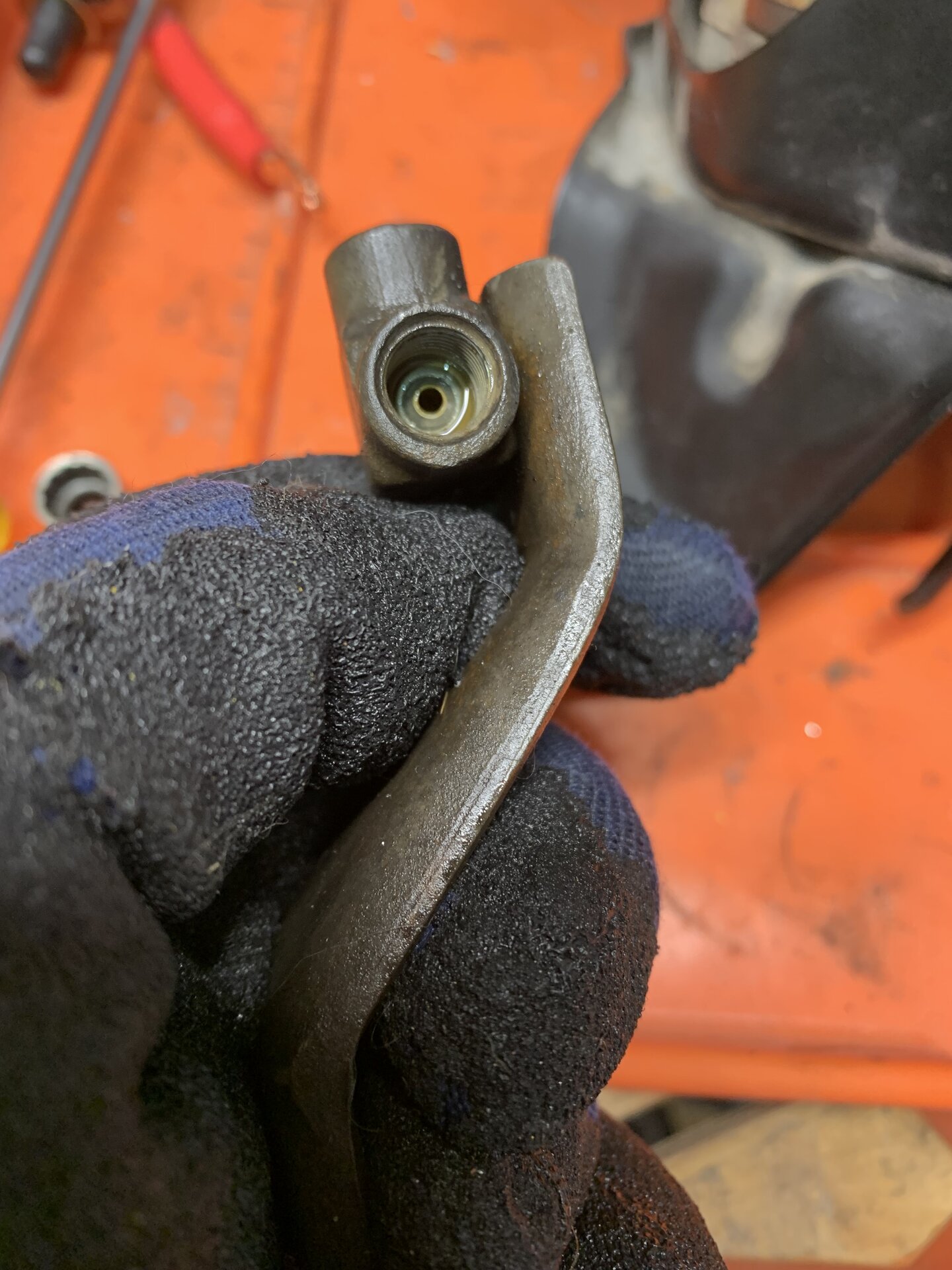

One thing I meant to mention from my ABS/LSPV delete was a finding that seems to support the theory of air being trapped in these ABS units. Here is the elbow fitting on the DS fender well that gets moved back to connect the lines at the LSPV, notice how the fitting facing the ABS was dry when I separated it (last pic)

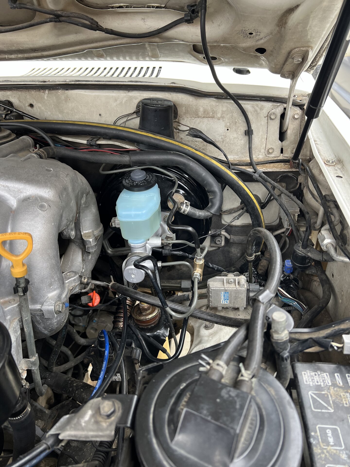

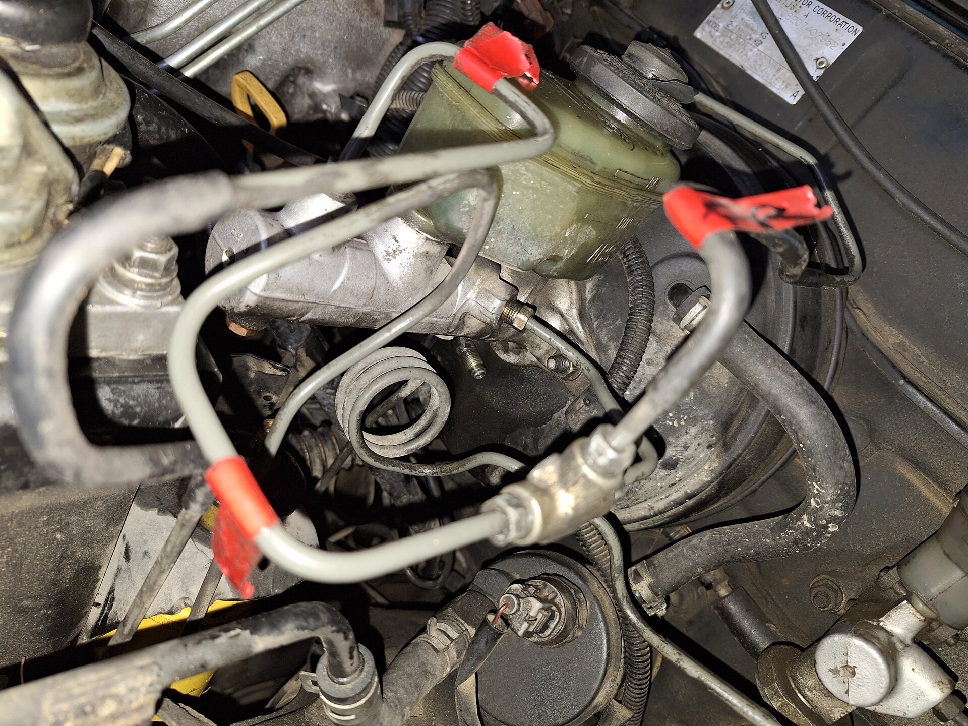

From the pics it appears that other have been using the rear outlet on the master cyl for the front brakes. Is that correct? Is there a difference in volume between the two sections of the master cyl?

Is the line/bracket at the rear of the left front the return from the lspv, or the supply for the rear? It connects to the tee under the master cyl, which connects to the rear section of the master cyl, and the abs pump. I was just planning on blocking the one going to the abs.

for me it's the return pf lspv
I looked at my hzj79 without abs and I do the same on my 80.
apparently there is a difference between master cylinder with abs the output of the front and rear brakes would be reversed...
Would that make a difference if you deleted your abs and LSPV, or replaced your abs master cylinder with one for w/o abs?

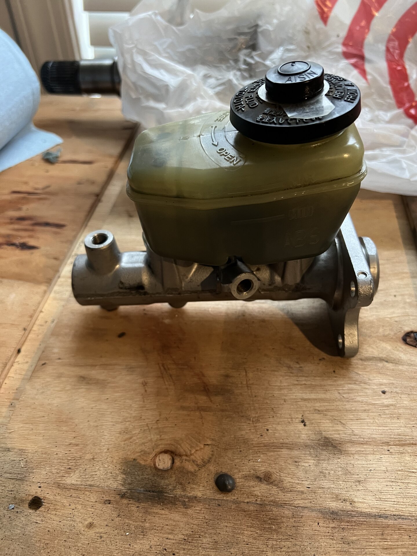

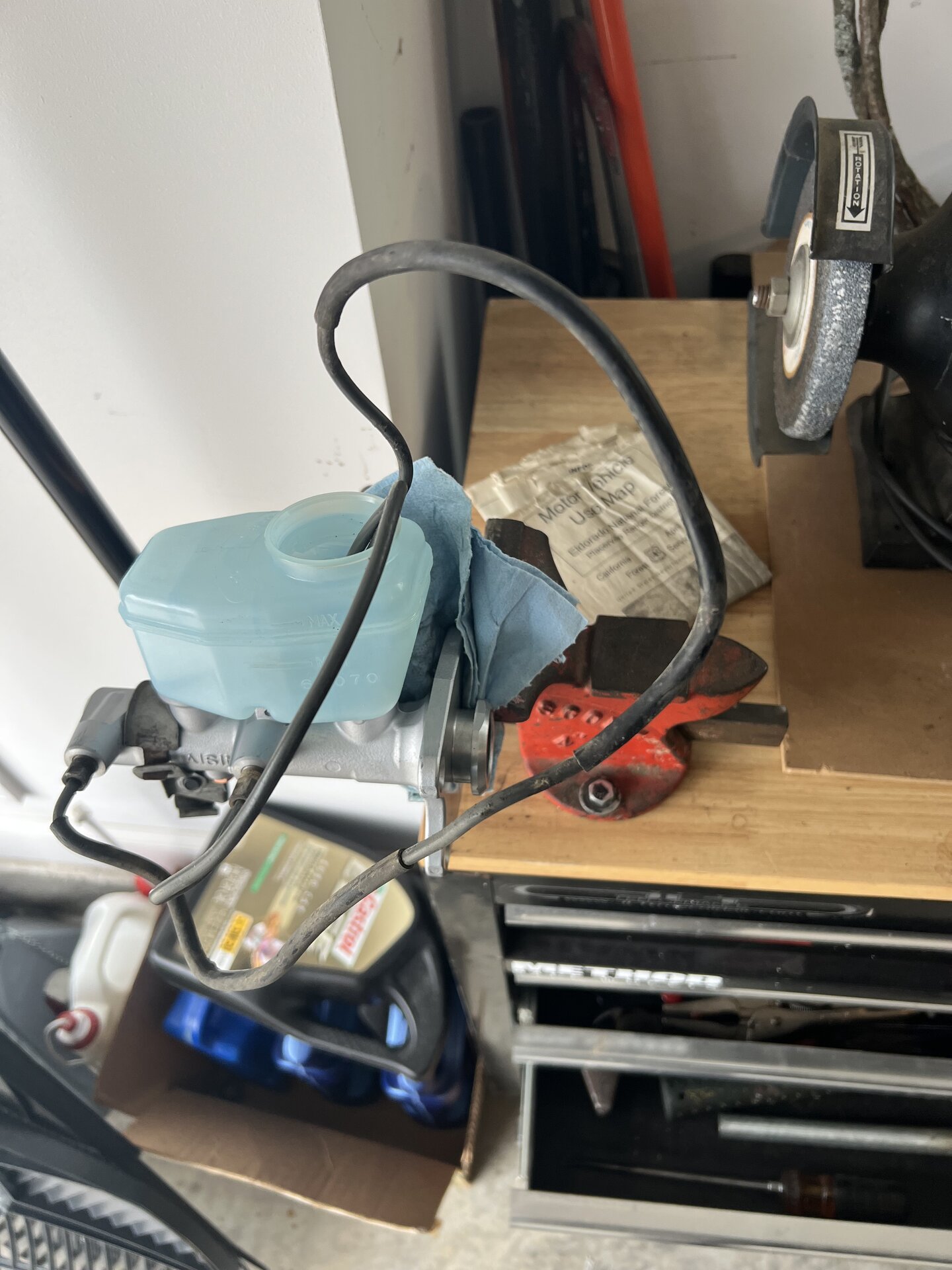

Did the full delete, installed a new MC, new booster, replaced frame to axle brake lines with braided lines from @sleeoffroad, used the “L” fitting from the LSPV for the rear and mounted it with the spacer from @Outsane (solve function). I purchased an Aisin (Advic) MC for non-abs and had to bend the line a bit more since the “F” line is horizontal instead of vertical in my old MC. I used some old brake lines to bench bleed the MC.
Got it all bled and then the battery was dead.
After waiting for the battery to charge, I took it for a drive. Immediately I could tell the difference! The brake pedal is a lot more responsive. Well worth all the work ! I second what @alia176 suggested by using a long 12mm wrench to remove the proportioning valve bracket.

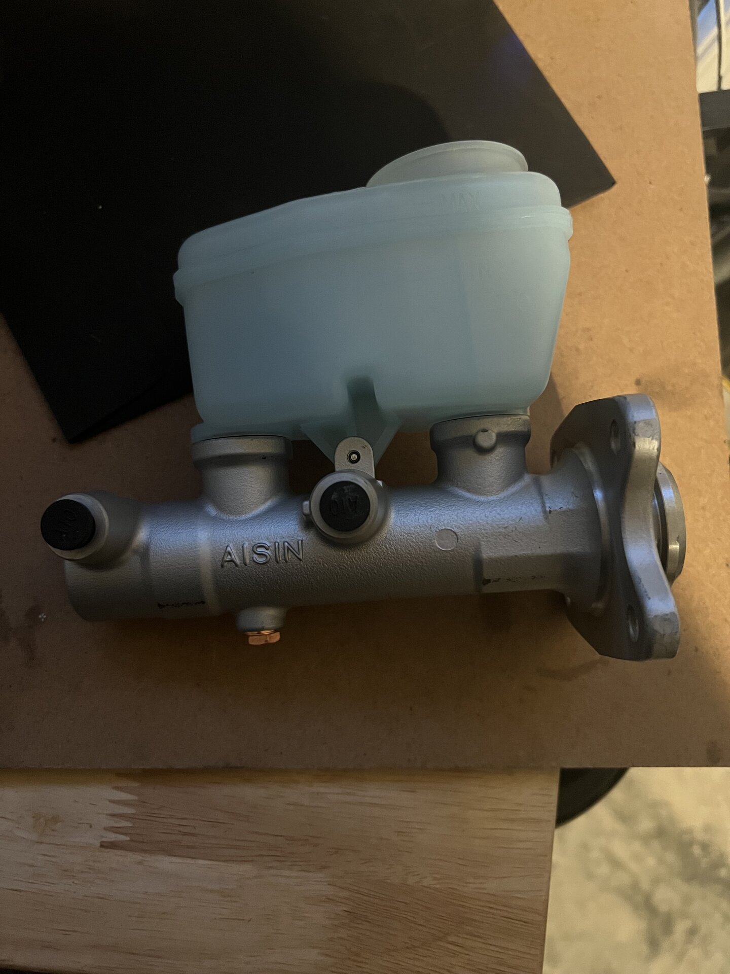

I used the circled MC part number. Check your door plate to confirm year otherwise you’ll need the one I put a check next to. FYI Advics is owned by Aisin and they are stamped Aisin.
