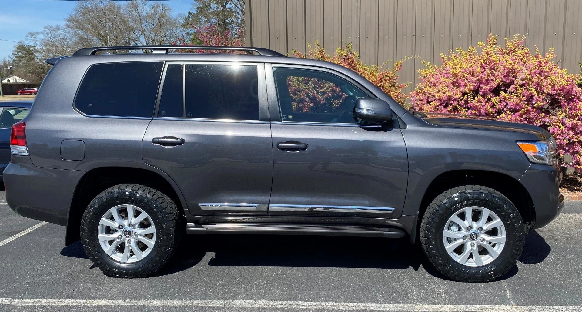

I have the 275/65r18 toyo ATIII's and have been very happy with it. Yes you could squeeze a larger tire but like you said, you are going to pay for it in weight and stiffness/ride quality. This is what they look like with a ~2" lift. I think they would look very good and fit nicely on stock height:
Be aware that toyo makes a 6 ply and a 4 ply in that size. I chose the 6 ply. The 6 ply has a deeper tread and a more agressive sidewall than the 4 ply. It is a significantly more aggressive looking tire. I was not willing to put a 10 ply tire on my vehicle, and the ATIII was one of the only options I could find for an 18" rim. I have had 4 sets of these tires on different vehicles and always been happy with them.
