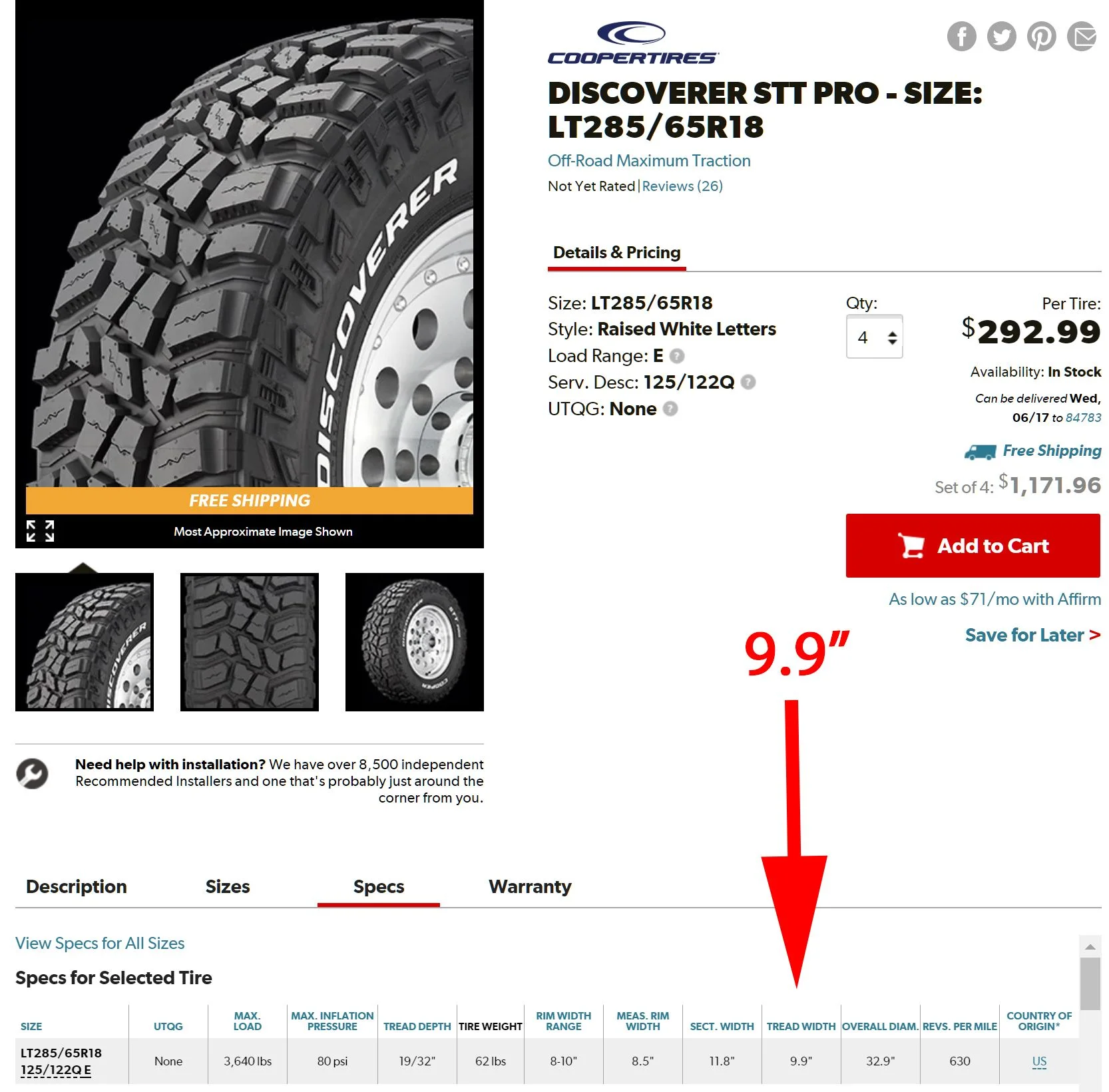

Surprised the Cooper STT Pros where so much wider so I spot checked. Still wide, but shows 9.49" here.
Take it up with TireRack:
No fault of yours and I appreciate you collecting that data in a list. No need to propagate TireRacks error here, as this thread could be used by others in the future to ensure fitment.
TireRack, acknowledging that there is no industry standard procedure for measuring tread width, does their own measurements. Thus, when comparing tread width measurements, they should all come from TireRack to assure direct comparability.
From TireRack site (Tire Tech Info - Tread Width) (emphasis mine):
Unfortunately there isn't an industry standard that establishes a single procedure for how to measure tire tread widths. And since tire manufacturers can use different methods, their published tread widths would only be meaningful when compared to other tires measured the exact same way.
This makes it challenging to compare tread widths of one tire brand to another, and most tire manufacturers have simply chosen to eliminate tread width dimensions from their brochures and websites.
Because tread width is still a dimension of interest to our customers, Tire Rack has established a common measurement method to address this issue.
The Tire Rack tread width measurement tool helps us define how much of a rounded shoulder's over-the-horizon tread width should be included in the measurement. We use a 20" long tool made with square tube featuring a 30° bend in the middle. Centering this tool on top of the tread design helps us approximate how much of the tread will be in contact with the road when in service.
TR Tool with Round-Shoulder Tread
Measuring the tread width of rounded-shouldered tires is defined by centering our tool on top of the tread and measuring the distance from the outboard to inboard contact.
Once we know the points of contact, we then use a flexible flat steel ruler to measure between those two points. This tool can be used on tires with rounded shoulders, as well as those with square shoulders.
While Tire Rack tread width dimensions may differ slightly from those published by the few remaining tire manufacturers that still offer them, it will be applied universally.
So... I would suggest when comparing tire tread widths, one do so from a common source - either from entirely within a manufacturer's site or entirely within TireRack.
