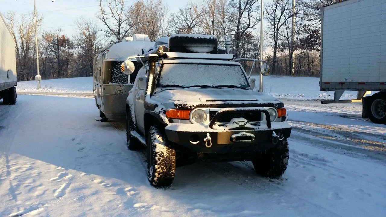

Greetings! Old retired guy here with a '07 6M fairly modified FJC.
After pulling our Airstream with the FJ (many said it wasn't a good idea) sucessfully from Florida to Alaska where we were campground host at the Mendenhall Lake Campground (Yes - the TRD Supercharger was a tremendous help) my lovely bride and I now are full-timers. We love our FJ and believe anything is doable if done well - this applies to towing behind our Class A.

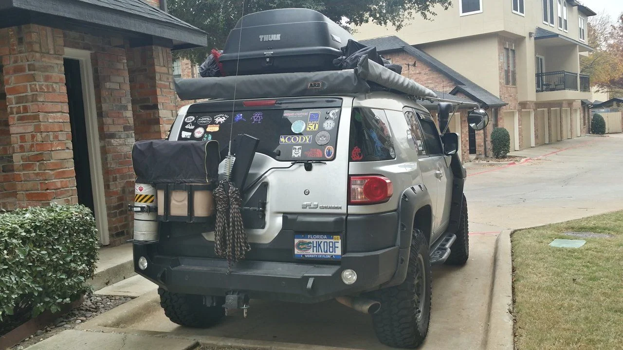

I have done a frame-off restoration of a '92 YJ and loved the Jeep platform. It's like a little tank. But I made the mistake of test driving a used '07 6M FJ - I've had her for three years now and after a few mods e.g. ICON, TRD SC, Hutchinson's, DeMello, ExpOne, Warn, Total Chaos, Bushwacker, and more. . . I simply won't part with the beast. Also, the Jeep simply isn't like the FJ - apples to oranges. Both great vehicles, but not the same.
