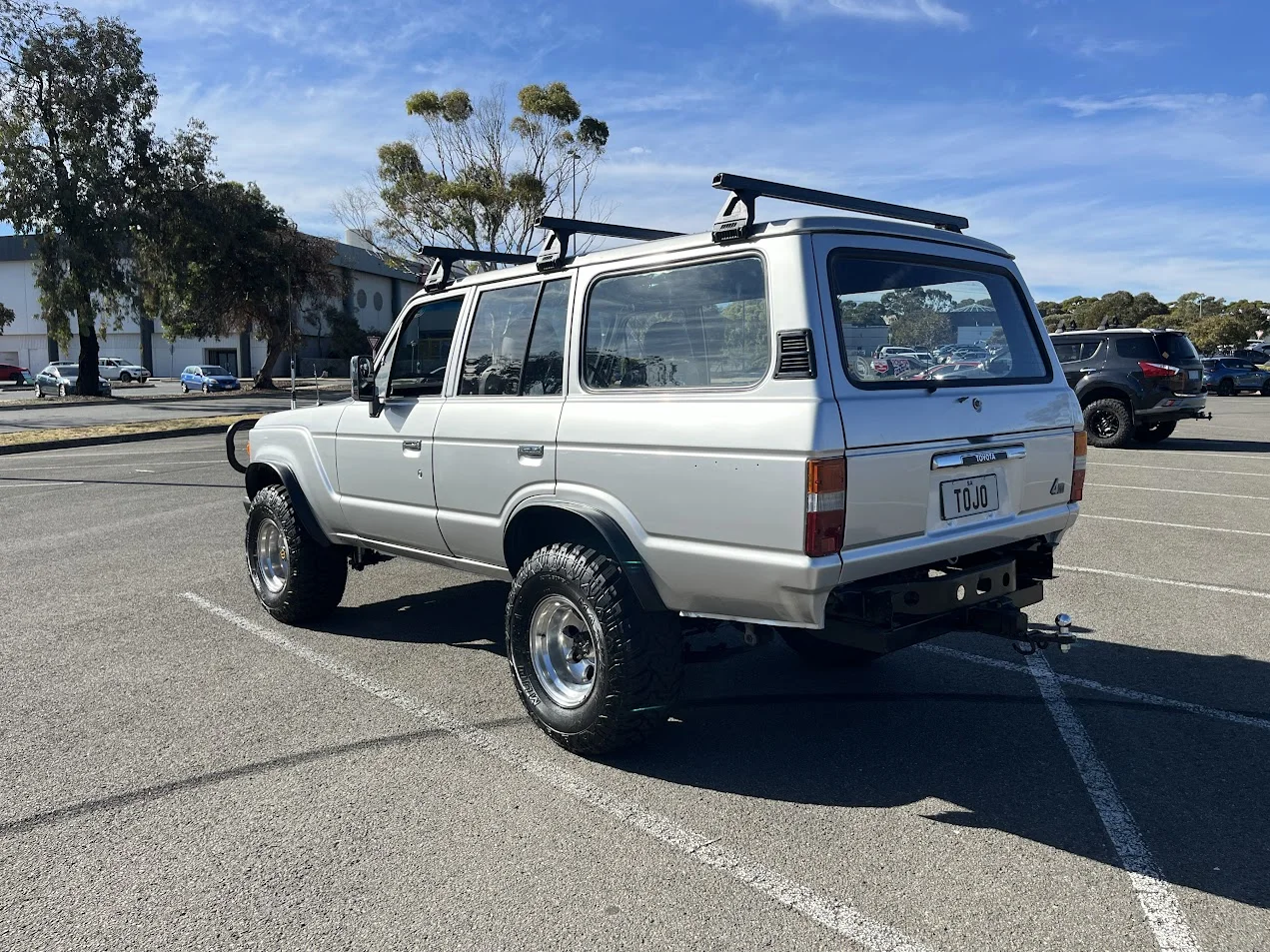

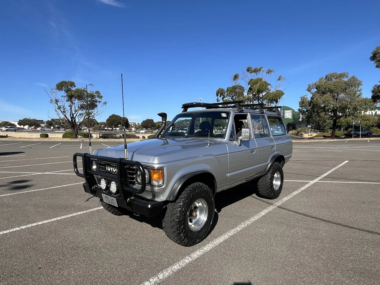

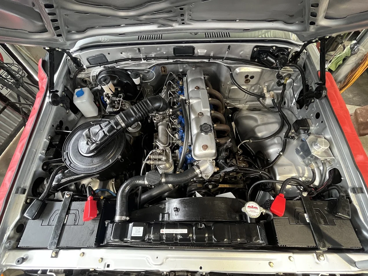

This is the culmination of a 3.5yr build of an HJ60. It's an amalgamation of about 5 different vehicles. The engine is from a rusted out beachside 60 series that I think had about 250,000klms on it. No turbo fitted, but It genuinely feels like its turboed, responsive, good acceleration. I am in fact quite taken aback at how well it drives. 65klms on it so far since I put it back on the road.
I am pretty sure its a factory unopened 2H. I have had the injectors rebuilt, I set the valve clearances and rebuilt the cooling system. Other than that I havent really done much to it. It has quite a minimal exhaust with extractors on it, its noisy under wide open throttle - sounds angry - its probably noisier than it should be. I really dont know what contributed to the power the most, maybe the fresh injectors, small exhaust and headers and lack of rear fitout (ie lower kerb weight) I guess it all adds up. I'll try and quantify the performance at some point, but I know I wont need a calendar to measure the 0-100kph time.

No noordeman cam in it.. almost certainly its factory unopened.
The Noordeman cam is just a cheap chinese cam, nothing special.

Interesting. I've just got a set of Pacemaker Extractors out of Aussie and will fit them up. My 2H has 280,000ks unopened. Injector refresh and valve clearances would be next on the list after that. Hope after this I get similar results to you.
