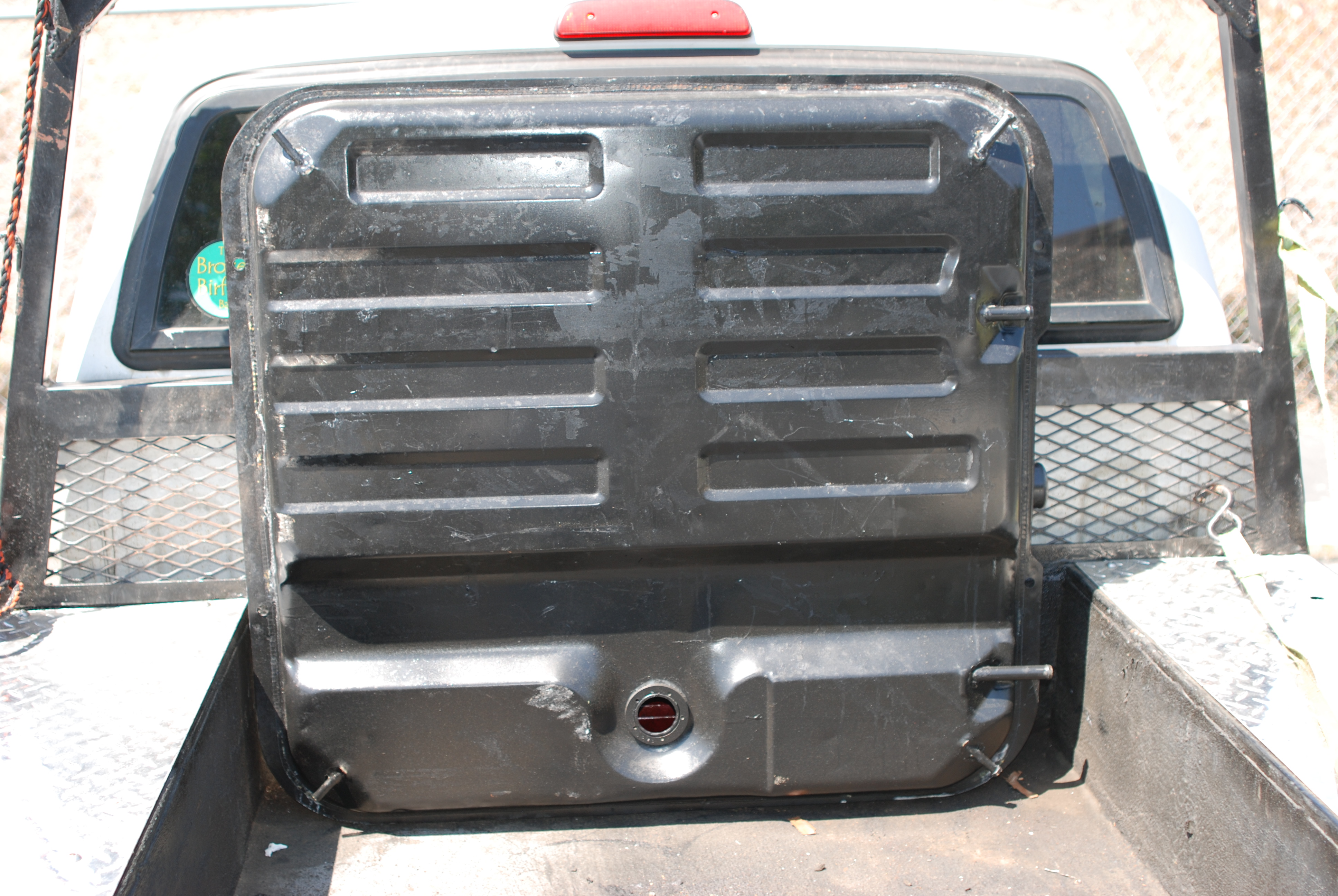

Lil'John, I feel your pain and don't have any different advice. I'm hesitant to drop mine after reading this but have a leak that appears to be on the left side top of the tank, probably not the filler hose as I originally thought nor the suspect vent hose that I fixed. Since you have the tank out would you post a pic so I can refer to it in chasing my leak?

On mine, my tank had a crease in the top that was leaking, I guess resulting from iron pigs flying....
bk
Front range, I'll take the lazy route and put a bunch of fullsize pictures here:
http://www.trail55.com/tank

If you need any other specific pictures, I can retake them.
You can try:
http://www.trail55.com/tank/DSC_0026.JPG
also there is 27-31,33 and 34
Be warned, these are like 1-2Meg each.:eek:
Size isn't a problem but I can't access the first link - Forbidden! :frown:
