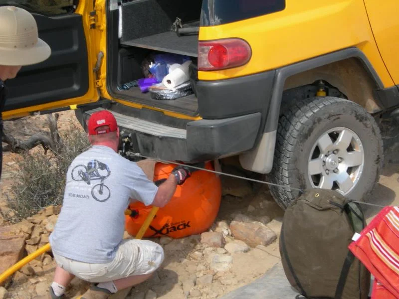

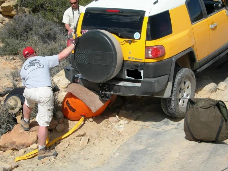

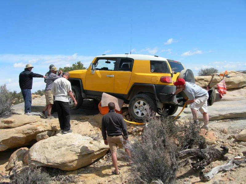

I've been involved it two recoveries in Moab using the X-Jack and like it a lot personally. Its on my list of items to buy. It only took a minute or so to fill each time using the exhaust. We did not use a compressor. Both times I felt the vehicle was very stable, lifting on broken rock.
You can loose a truck off a hi-lift too. Given the choice between a hi-lift and the x-jack I would carry a hi-lift as its more versatile. But if I had both I'd personally use the x-jack more often for standard jacking procedures based on my personal experience with both.
Edit: Found a couple pictures. This FJ was high centered on the fuel tank and rear diff. We first raised the rear and winched it sideways to get it off the rear diff. Then used it under the rocker to stack rocks and drive it out. I don't have any pics of the other recovery.

A buddy of mine has one of these air jacks, which we have used on off-camber trails as a safer option than the tippy old HiLift jack.
The air jack needs to be placed in the correct spot under the truck to work right (this may take a few tries.) One needs to hold the filler cone *tight* to the exhaust pipe to get it to fill quickly (revving the engine doesn't hurt either!)
