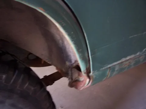

If anyone has a parts truck and the passenger qtr is not gone I need this piece.

3_puppies, you got this piece on one of your parts rig?
No, it's in the same shape, as the one you have. Paul
The steel looks good on that bent up section. I'd clean it up with a grinder, tack on some big washers and use a come-a-long to pull it back out. Some hammering an dollying and you'll be close enough to finish it out with a bit of bondo...prime..and paint.
