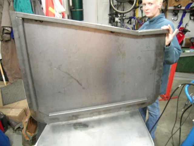

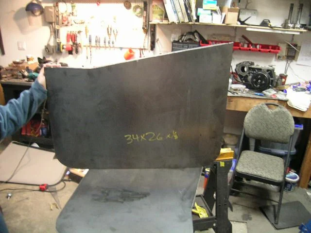

Back to the doors: I built mine out of some 1/8 steel and some 1"x 1/8 square tube. You can get latches at Tomcat trailers.
They work great, and fit my soft top doors as well. A pretty simple build, really.

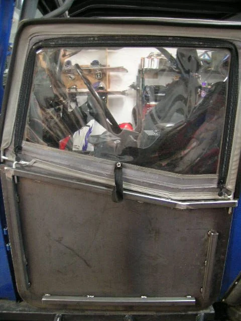

Here is a shot of my hinge setup. I used some 2"x 1/8" flat bar and welded a piece of 1/4" round bar to fit into the stock hinge hole. Then I bent the flat bar a bit to make the door sit flush (check out SOR's (Specter Off Road) aluminum half door page here They also have door strikers for $10 each (see next paragraph). You could certainly use stock hinges, but I didn't want to have to re-set the stock hard door hinges after removing them. This way I can pop these off and throw the stock doors right back on with no adjusting.
As far as the latches go, I got these from SOR, but you can get similar ones cheaper (with the interior opening capability) from Tomcat Trailers. You would just have to fab a stricker latch, which is quite simple.
