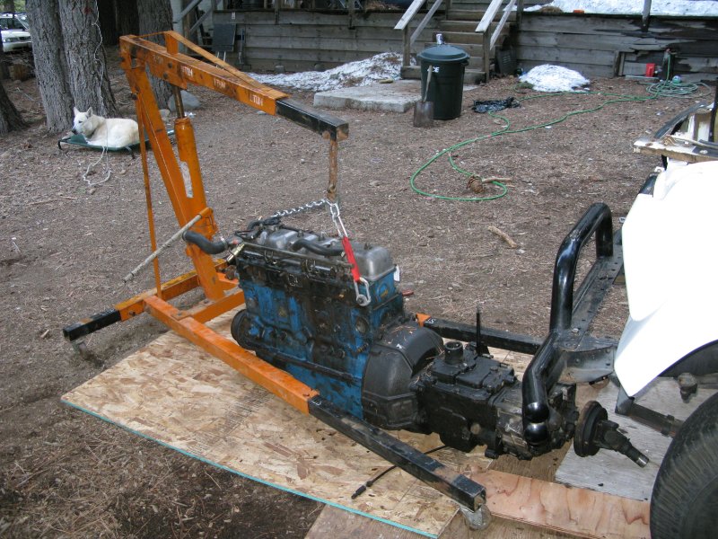

I'm pulling my 2f to rebuild it and don't have a hook to grab to. Just thought I would see if I could locate a couple. Seemed a little safer than trying to hook to the alt brace and a bolt!
I use the head bolts to lift the engine...
Same here. On my last removal, I did pull out two of the head bolts, installed two flat metal brackets ( home made) and reinstalled the head bolts. I just "made" a couple new brackets yesterday if you need stout metal.
Nevermind... carabiiners work too!
