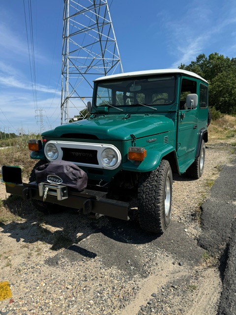

Rear 1/4 are cut for the flares, missing the rubber pads on the windshield hold downs, make sure the strange rear bumper isnt welded on. Gauges cluster, ashtray, inside gas filler cover and glove box door should be silver. It's also missing the lower portion of the gas filler cover. You need pics of the engine compartment and underneath. Things were not removed when it was painted which is a sign of possible short cuts. Overspray. It's missing the under dash fan/heater duct between the fan and heater. The frt seat brackets are not correct and look iffy and i dont think the seats are correct. I think it has more miles on it than odometer is showing. Take a magnet and look for filler. Lift the Mats and see what's under them. Do they have b4 paint pics?

Seems like a lot of rust for a California/New Mexico truck. Especially for 23k.
My gut says it is 8k overpriced.
However it does look nice, complete and mostly original.

I bought a 2/80 40 end of last year that lived it's entire life in Nevada desert. It has very minimal rust overall, but has rot in the exact same place as that '79, even the doors. Drivers floor has holes in it just like that one, the original drivers door is rusted at the bottom just like that one, and the rear of the tub is rusted at the sill area. They all seem to rust in the same place due to the way that Toyota laminated the body panels and structural supports. Doors rust if owners don't keep the drain holes cleared at the bottom of the door just due to dust and debris accumulation and moisture over the last 50 years. My personal opinion on that truck is I wouldn't let that rust scare me if it doesn't show to be in a lot of other places, like the body supports & frame. From what is shown in the photos, frame looks clean.
If I was buying anther 40, it would take a lot for me to buy a non-original paint truck (ie smoking good deal). I want to see all the flaws, I don't want them hidden by shoddy body work and shiny paint. Unless documented by seller, expect to go through all the mechanicals, regardless of purchase price. Do not buy a South American truck, regardless of price.
