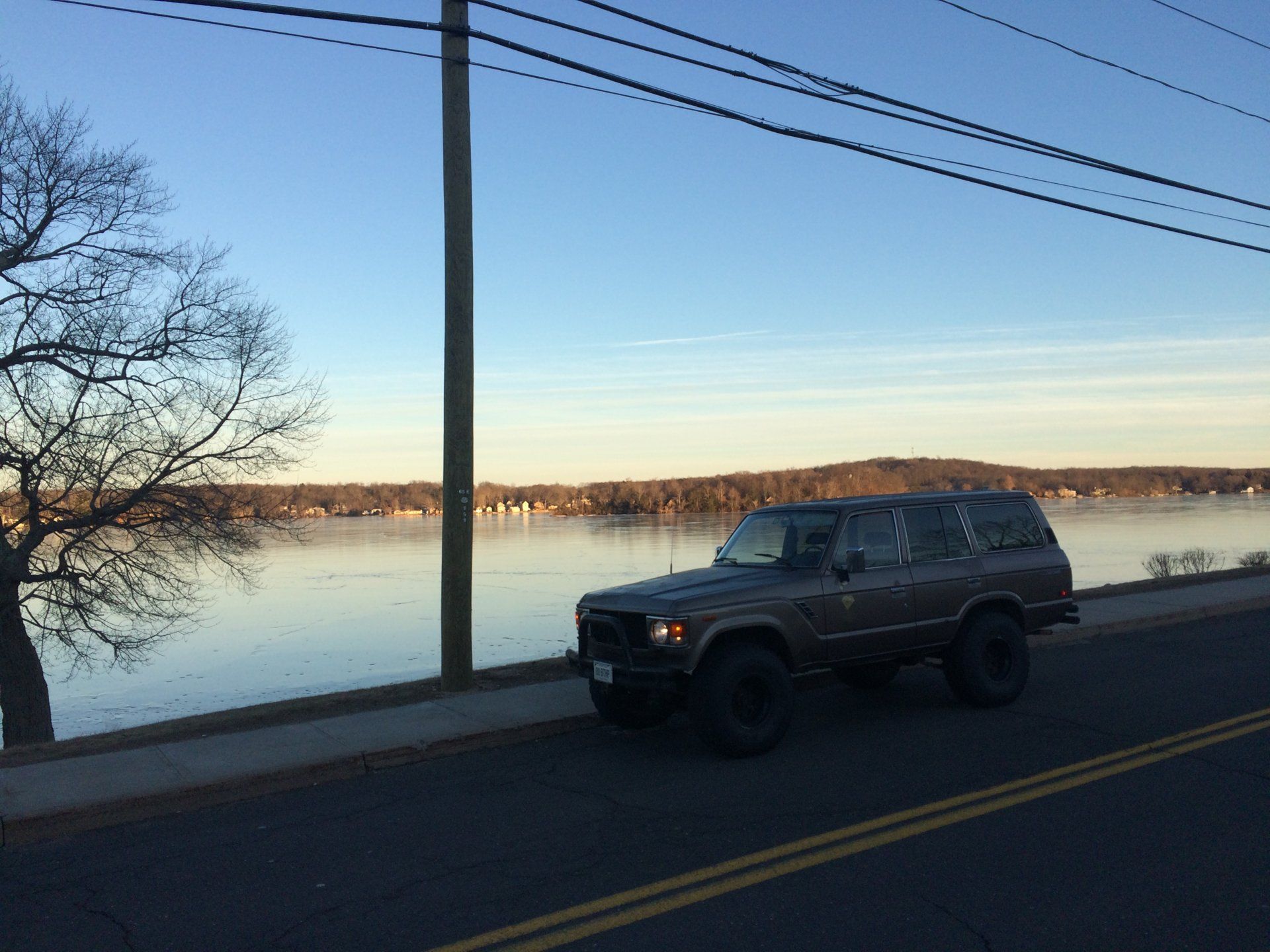

Took her for a spin around the lake and she's running pretty good. s*** eating grin and I am bouncing all over the place... funny how complete tractor they really are. A hard brake and she stalls but starts right back up with gas while still rolling... that happened a few times with either slowing or down shifting. And have popping from the tailpipe with down shifting but feels stronger and more solid while trolling along than previously with that poorly resurfaced intake manifold.
Not sure I'd trust her without pulling the choke in a busy area for slowing and such but seriously from the start of a day with two dead cars to one back up and running I feel a million times better. Talk about living on the edge.
