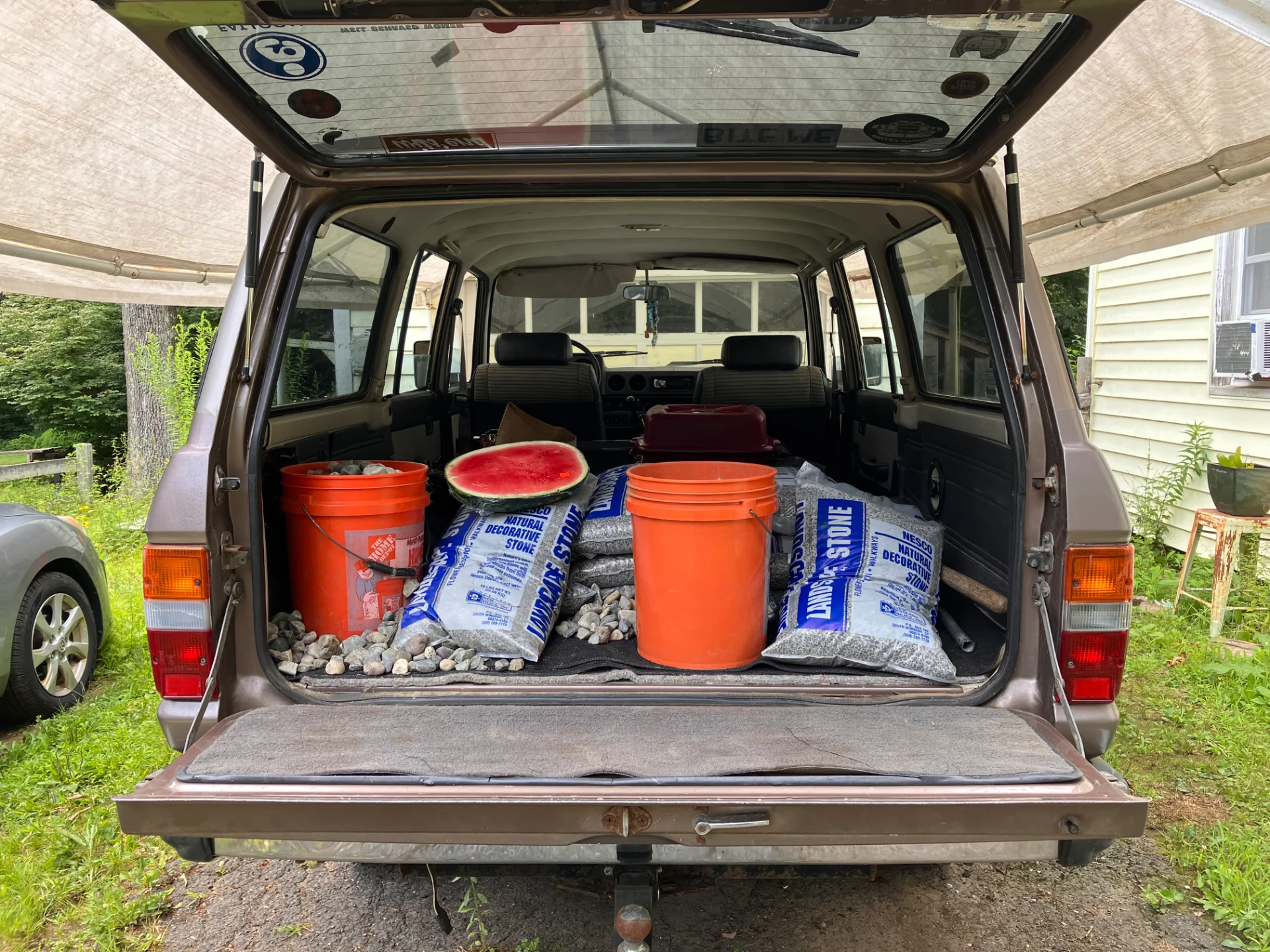

Kid and I loaded her up today. 600+ pounds of pea gravel and two 5 gallon buckets of stone and watermelon that holy crap went up in price!
