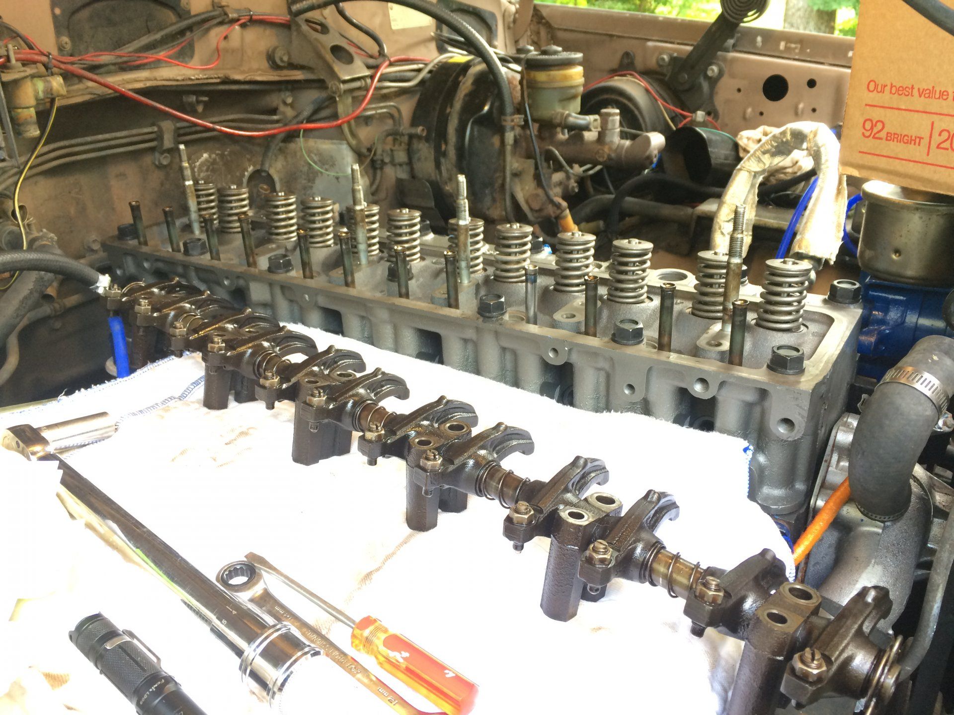

So I had the manifold back on but to my annoyance one flange had a smidge of a lip that was keeping the last bolt from threading in.

Good job Felicity. It makes me smile and think back to when I rebuilt my 2F. First motor I ever rebuilt and it is running great 3000 miles later. Your attention to detail will be rewarded with a good running engine.:)
Thanks Jer, I appreciate the compliment! I went to your build and started reading. Now I remember reading it ages ago and being dumbfound and in awe. And now here I am. Only a top end but it's still huge for girl working on it part time in her driveway w/ far less 'right' tools too!

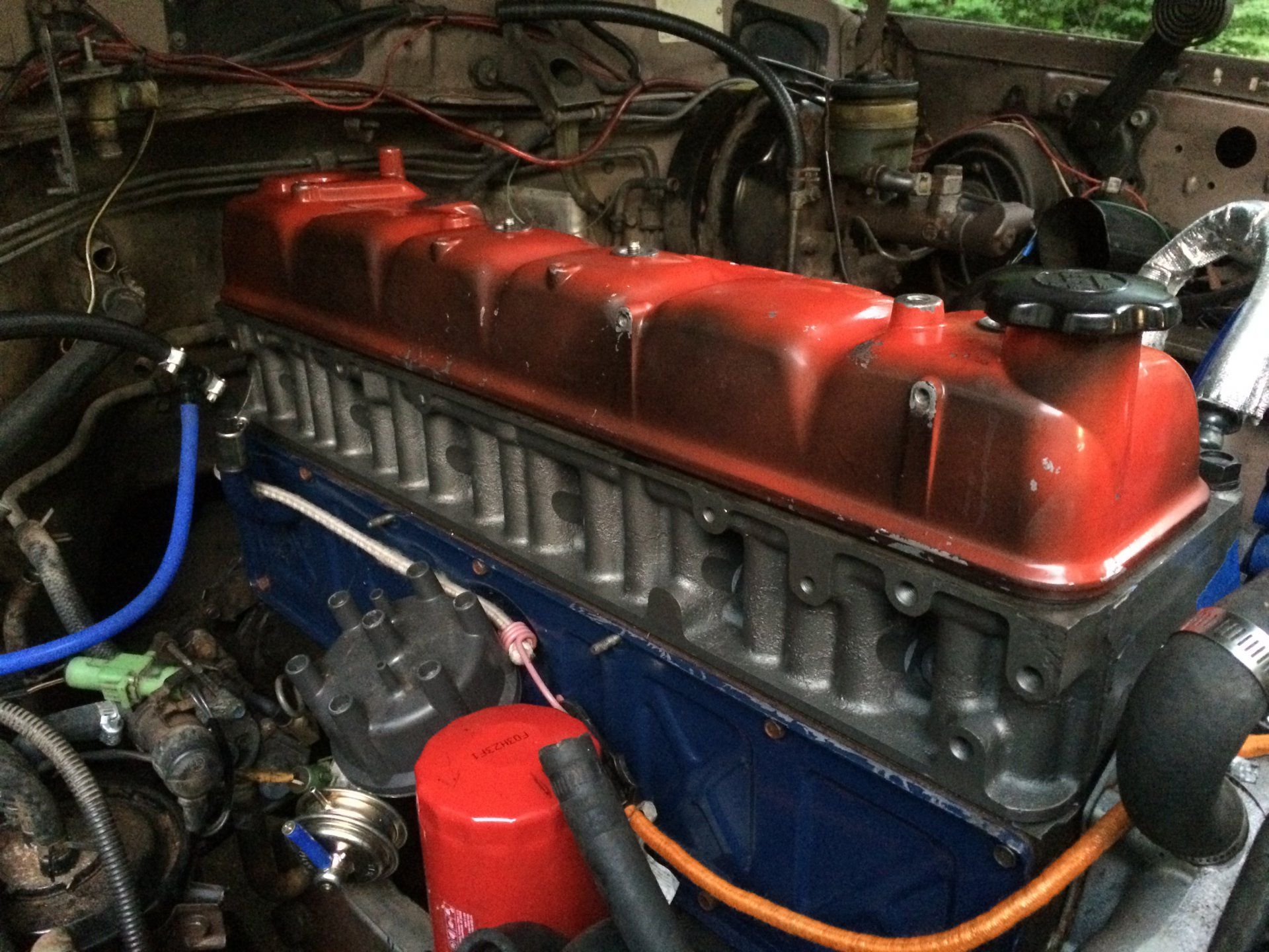

Manifolds are back on and torqued.
Pulled the oil cooler and the oil filter bracket.

Oil filter bracket wiped semi clean, reattached then oil cooler cleaned and painted w/ new o-rings and copper gaskets on the hollow bolts.
Lower thermostat housing reattached. BVSV 1 & 2 hooked into place.
Rear heater connections added back onto the manifold w/ high temp thread sealant.
