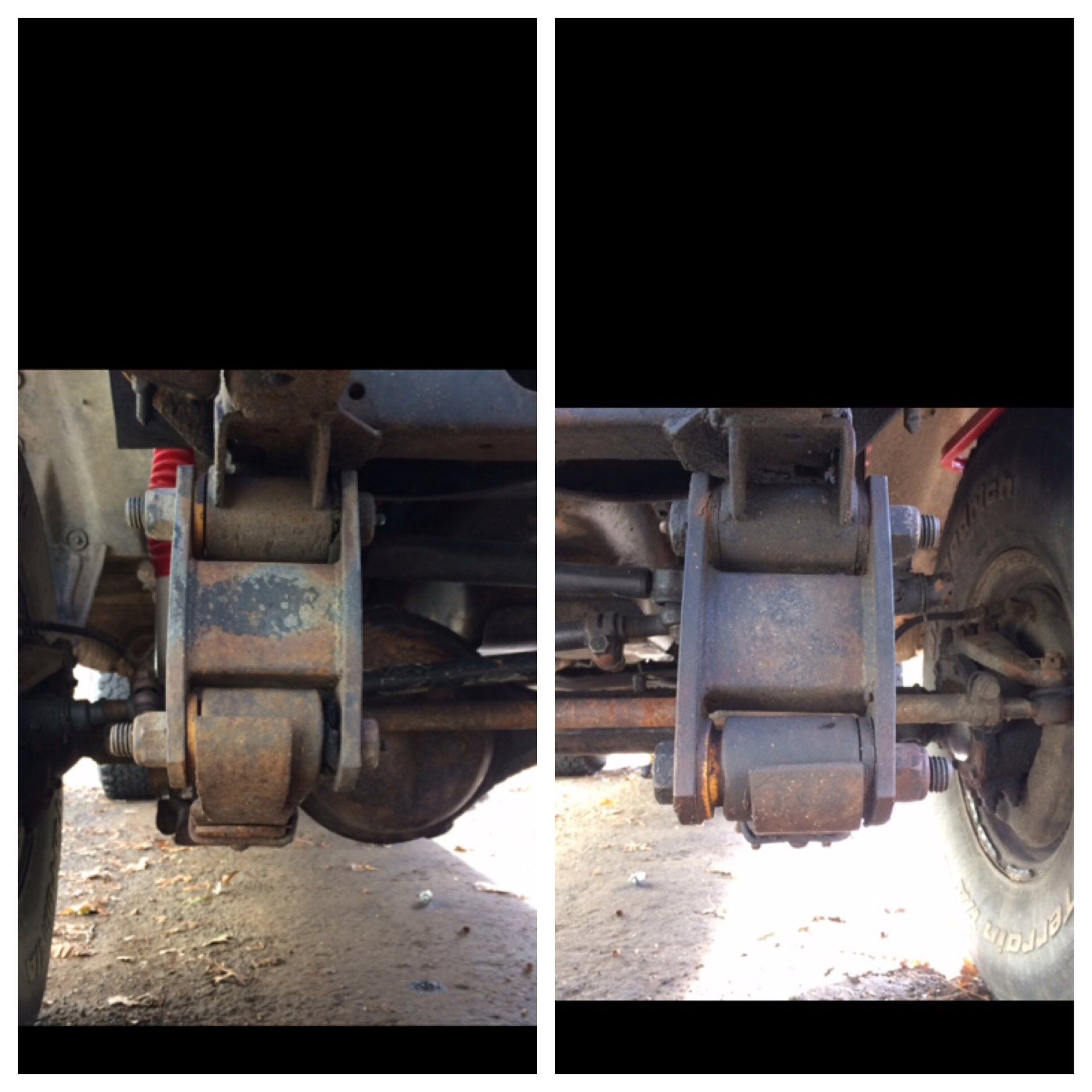

Also along the mention of motor mounts I can’t help but wonder about the appearance of my leaves from ahead. Both are shoved way out toward the outer edge of the shackles. They’ve been like that since I bought it. I always wondered if that was significant of something misaligned.
No technical savvy, per se just brain storming. The shackle closest to the diff has a slight curve towards the inside of the truck. I can't see the same curve on the other shackle, if it has any curve at all. Going way out on a limb here but maybe the PO jumped or bottomed out the truck really hard causing the curvature and misalignment. If the truck landed more towards the passenger side and then rolled horizontal it might explain the curve in that first shackle. Just guessing here.
The bushings look toast. Just time to replace them. Check the fixed end as well. Need 6 per spring. You may consider new shackles if they look super corroded. The shackle pins would be the weak spot.

looks like the PO overtightened the shackle bolts, those are regular bolts drilled for grease. there is no shoulder on them so when overtightening them it bends the shackle ears inward
not sure what is happening with the second leaf in both packs. there is a clamp visible in the pics, doesn't look like it is holding things in line properly.
a few more pics might help.

I have a set of stock height greaseable shackles you can have for free.
That and bushings along with a set of new pins will get you most of the way there.
Thank you @HemiAlex... I do have bushings. Knew I needed them at some points as I could see the condition of what’s there. The pins I’ll add to my list.

The shackles and bushings aren’t a big deal. Get a map gas torch and a 5 lb engineers sledge and make magic happen.
I recently replaced my spring bushings. The springs looked offset like yours...replacing worn shackle bolt sleeves and bushings straightened them up. Here is what I did...rebuild or replace stock shackles??
