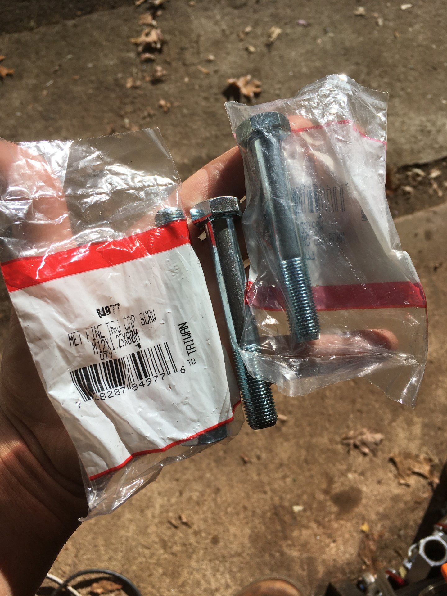

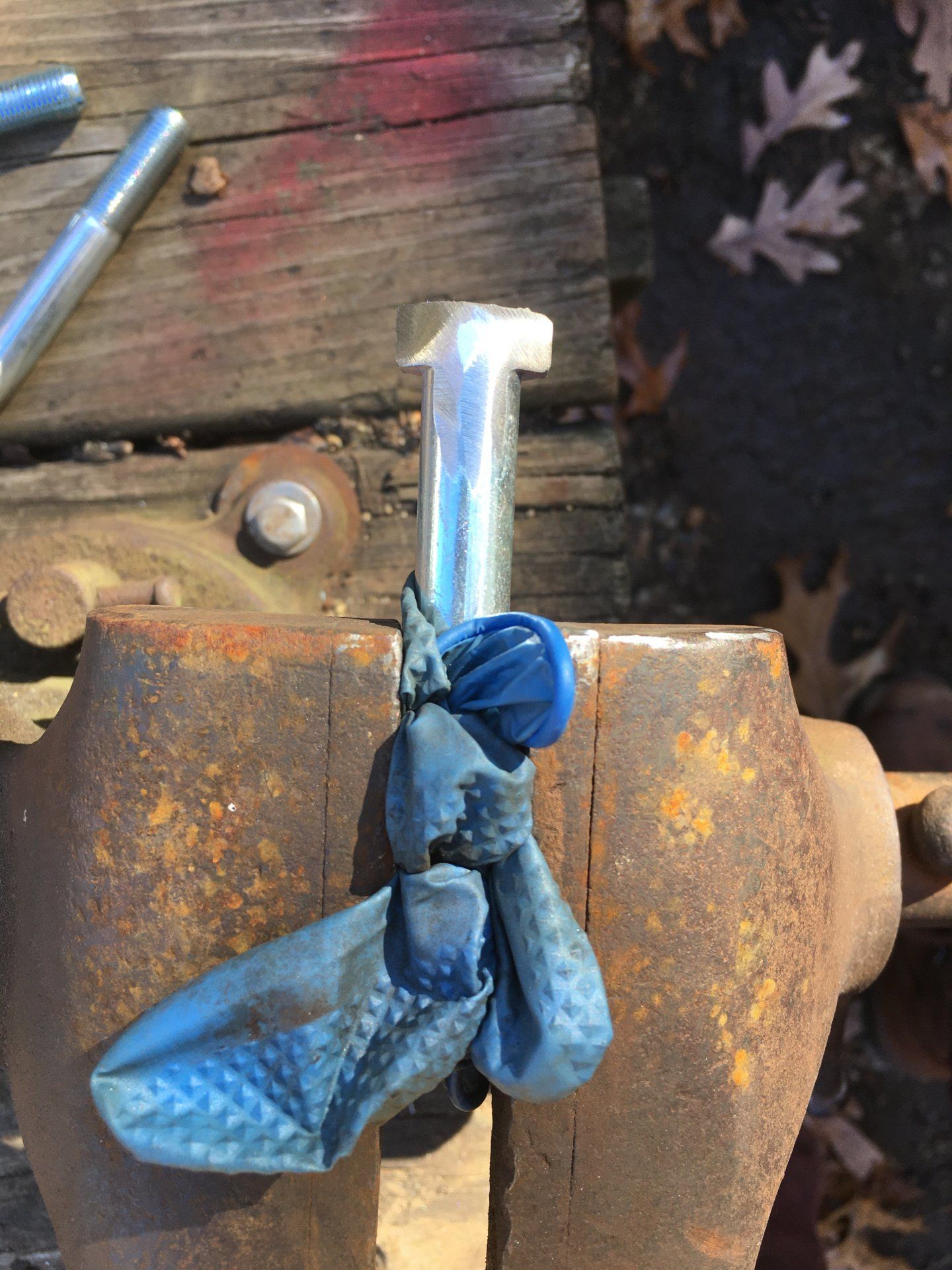

Well my pins were the wrong pitch. New ones from Napa this AM... first customer of the day! He had 3. Will shave off the heads so to not lose even that 1/4” of length.

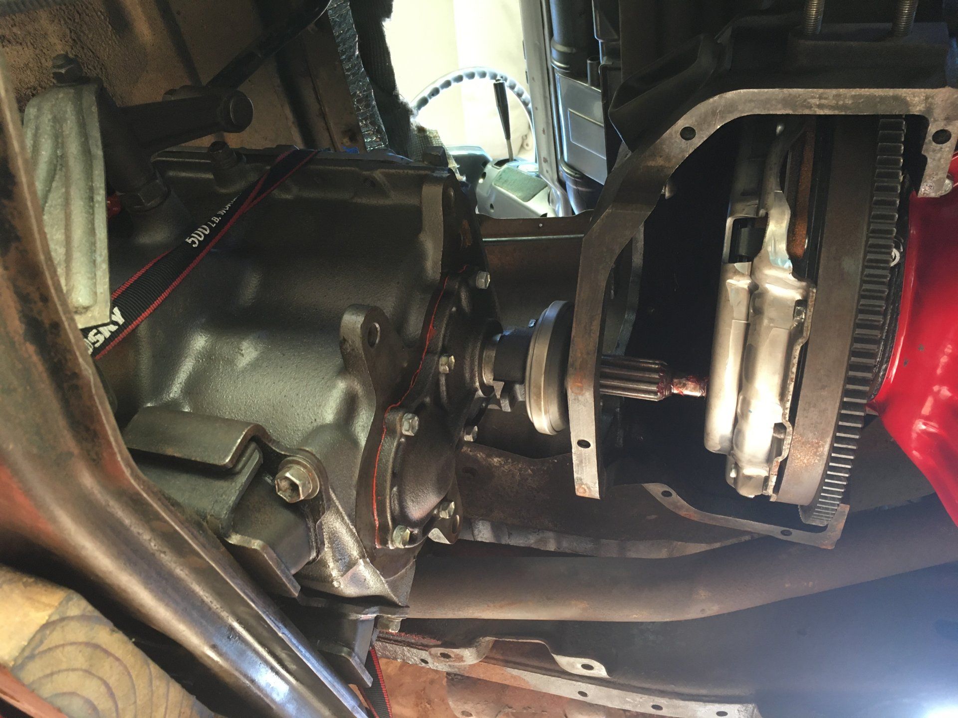

Flipped. Not too many pics. I by chance had a helper... or I’ll say, I was the helper, he was the the one who made it all happen. In awe how chance can work so well when we least expect it. He literally pulled in as I was just slightly coming to a few seconds of frustrated tears. This was the first time we ever really “hung” out and the guy just stepped right the f up, no questions. Still in awe.
Only this far to pull the cover and flip the disc.

My internet is down... so I can’t see any comments if any. Wah. He showed up out of the blue about 1:15, I suckered him in w/in 10 mins and we were done (including a couple water/pee (me) breaks) by 4:30. Holy gads does it help to have a strong knowledgeable person at my mercy. :)

Hmmm.... that task today was absolute tops. The jack stank pure and simple. I was funny talking what I might say to my friend I got it from often “hey doug, here’s your s***ty jack, thanks so much for letting me borrow it but it really is a peice of s***.” Once I got it lifted and the bolts out of the crossmember I realized I wasn’t even heavy enough to MOVE the combo. And I did make some dumb choices... no wood under the wheels on my crappy lumpy pavement was primary. I also had put wedges under the combo on the jack but didn’t strap THEM tight to the jack so as I pushed while by myself the jack was moving but the wood wasn’t so the jack went further behind and started to lose pitch under the TMS. That when I started to lose faith.
In total we used my floor jack and a block of 4x4 under the oil pan and his small hydraulic bottle jack to help out the crappy scissors jack.
