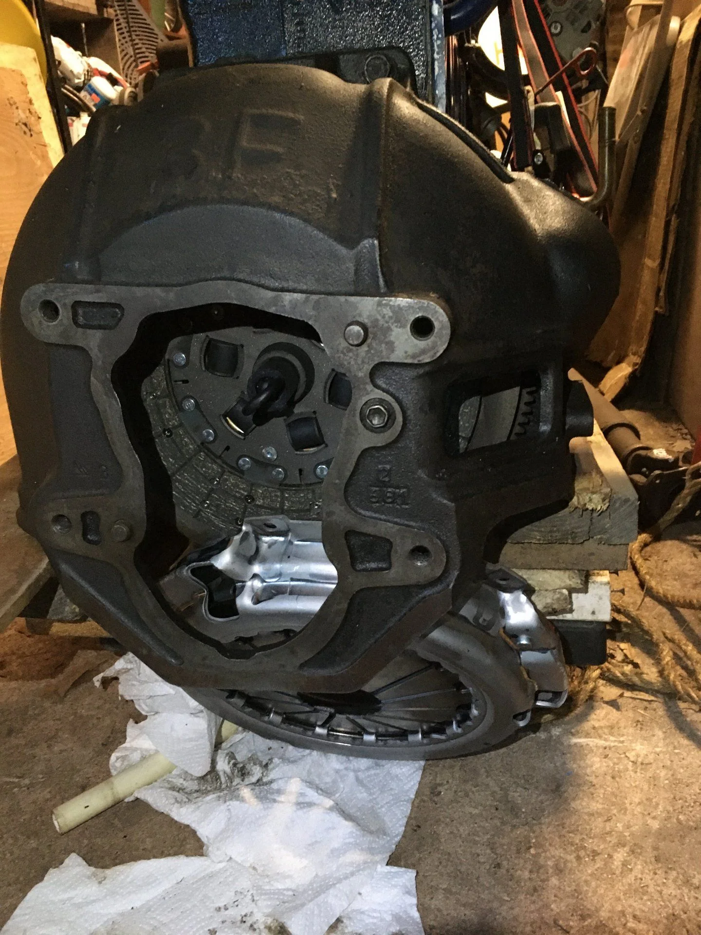

Well runs but won’t roll. Clutch possibly not disengaging fully, stuck to flywheel, etc... messed around w/ it for awhile w/ help from a few fav mudders. My slave and master were new in late spring ‘17. Doesn’t seem possibly they are bad but truck did sit for many months in the open air, weather.

Well it took reaching out to one last person for me to look through my pixs.... as soon as I saw it, plain as the nose on my face.
I’m officially in the club. Doesn’t that just stink.

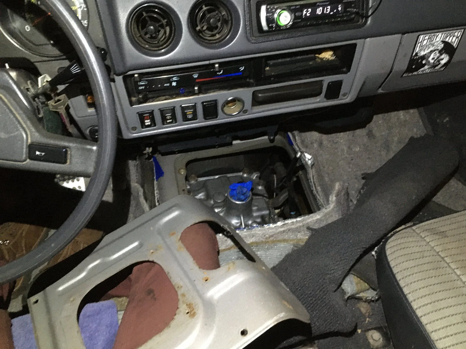

Good news is the transmission can stay on the stand. You just need to push it back a foot or so.

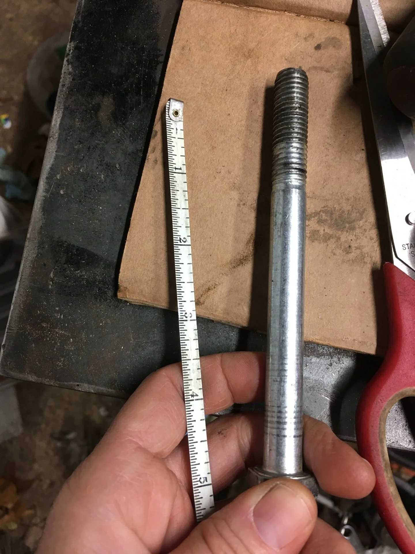

A FOOT?! I hope not. Hoping to go maybe 4-5” w/ the use of some guide pins I’ll make from the bolts I used for holding the engine to the stand, pull the cover, flip the disc and reinstall.
