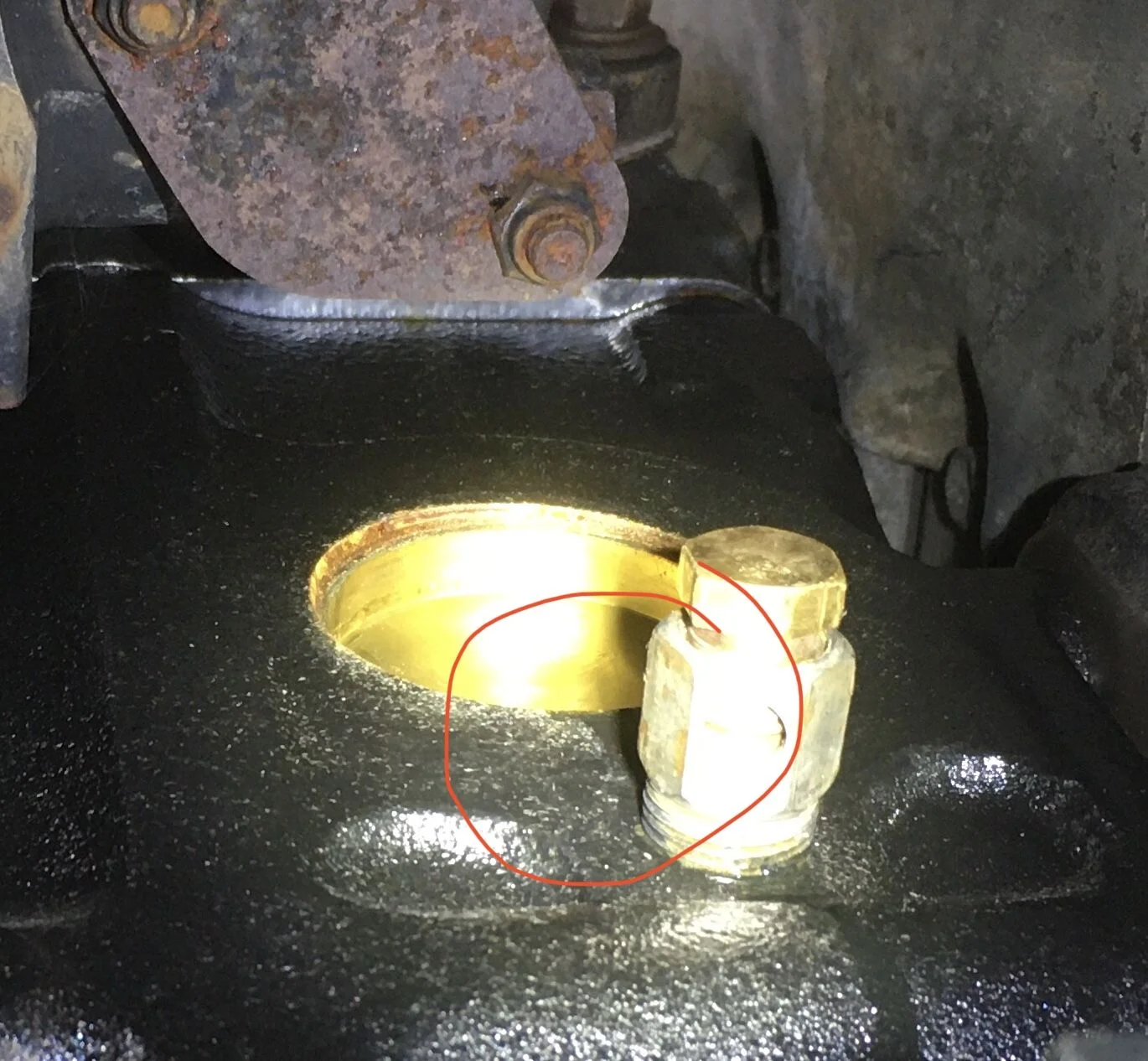

Ok don’t slam me... one suggestion already is to get an appropriately sized socket and attempt to tap it further in... driverside furthest back SIDE freeze plug leaking. Not the block drain. I was an ass and didnt paint them. They went in AFTER I painted the block so the rims of the holes have a layer of rust. Should have painted. It would have helped. Maybe I can get my hand up and scour around the edge and add a sealer after attempting to knock it in further.
Any other tips beside whst ive already been told and NoT pull the engine.
This happened to me but i had the front clip off was able to take a big socket and some 1/2 drive extentions enough to be able to swing the hammer just under the brake booster and tap it in just a little was still a pain like that not a whole lot of room and can't get straight at it. :banghead::banghead::banghead:
Tapped it in a smidge more from below in the dumbest reach ever w/ the side of a brass mallet while holding a socket that fit the rim of the plug and wouldn’t you know.... the leak got a bit worse.
Started spraying the bolts holding the inner wheel well or whole fender (you guys tell me) so I can remove it and have better access. If I have to empty coolant below that point to remove and replace.... UGh! How the F do I remove it anyhow!!! Muther FFFF!
My machine shop has some plugs they put aside for me. I’ll grab tmrw. What a pain. He said it won’t necessarily blow out but once it’s leaking he said they don’t typically stop.
