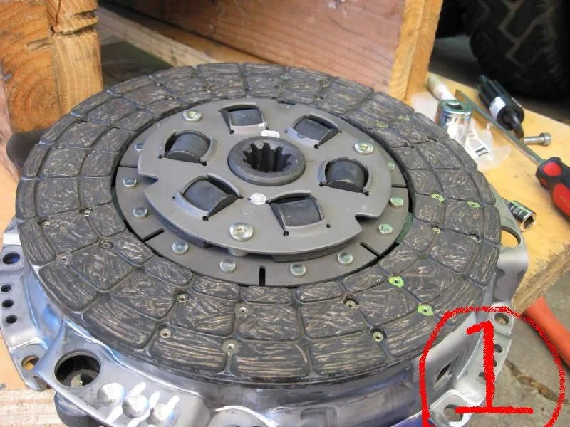

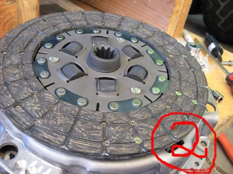

I've read the posts and FSM and it's still confusing -- Maybe I'm slow (maybe?) -- But I don't want to have to redo the darn thing.
So which side of the disc goes TOWARD THE FLYWHEEL (engine) ?
1 or 2 ? :confused::confused:
Well I went ahead and installed with #2 (flat side/ longer center) toward Flywheel (engine) ... Seemed to fit better that way...
Hope I done good.
S.
I am 99% sure the side with the snout(picture #2) faces out towards the trans. Just a note it will bolt up the other way but the clutch won't engage or disengage properly. There have been a few posts with this same question I will search and see if I could post a link.

Sorry, I can't tell you which way. But, if you get it wrong, I guarantee you that you will not be able to shift gears on the go! The guy who rebuilt my engine put one in wrong and it would not release. Later, someone said that most discs have something stamped on them to indicate which is correct. I guess my message is: If yours works, then you know that you got it right.
#2 goes toward the flywheel for sure, that is how i put mine in months ago . there is more room to accomodate the spring pack bulge (#1) on the clutch cover(pressure plate) than on the flywheel this is my opinion I could be wrong although this is how i did and have not had a problem
#1 faces the input shaft of the transmission. You will have to remove the transmission and flip the disk. Did you turn the flywheel on a lathe? Did the flywheel have hot spots on it? If not turned and there are hot spots, it will shorten the usage of the disk.

Spike, i hope that i'm not too late bud,#2 pic should be facing flywheel (engine) although i can't see pic 1 i'm dead positive #2 pic is facing flywheel.the reason is the side where it comes together and riveted is always facing pres. plate side i use to rebuild clutch disc in my younger years i hope that you get this in time and not have to do this over again. :doh:
John
Just read the rest of your comments and glad to know you went the right way,pic #1 finally showed up LOL.
