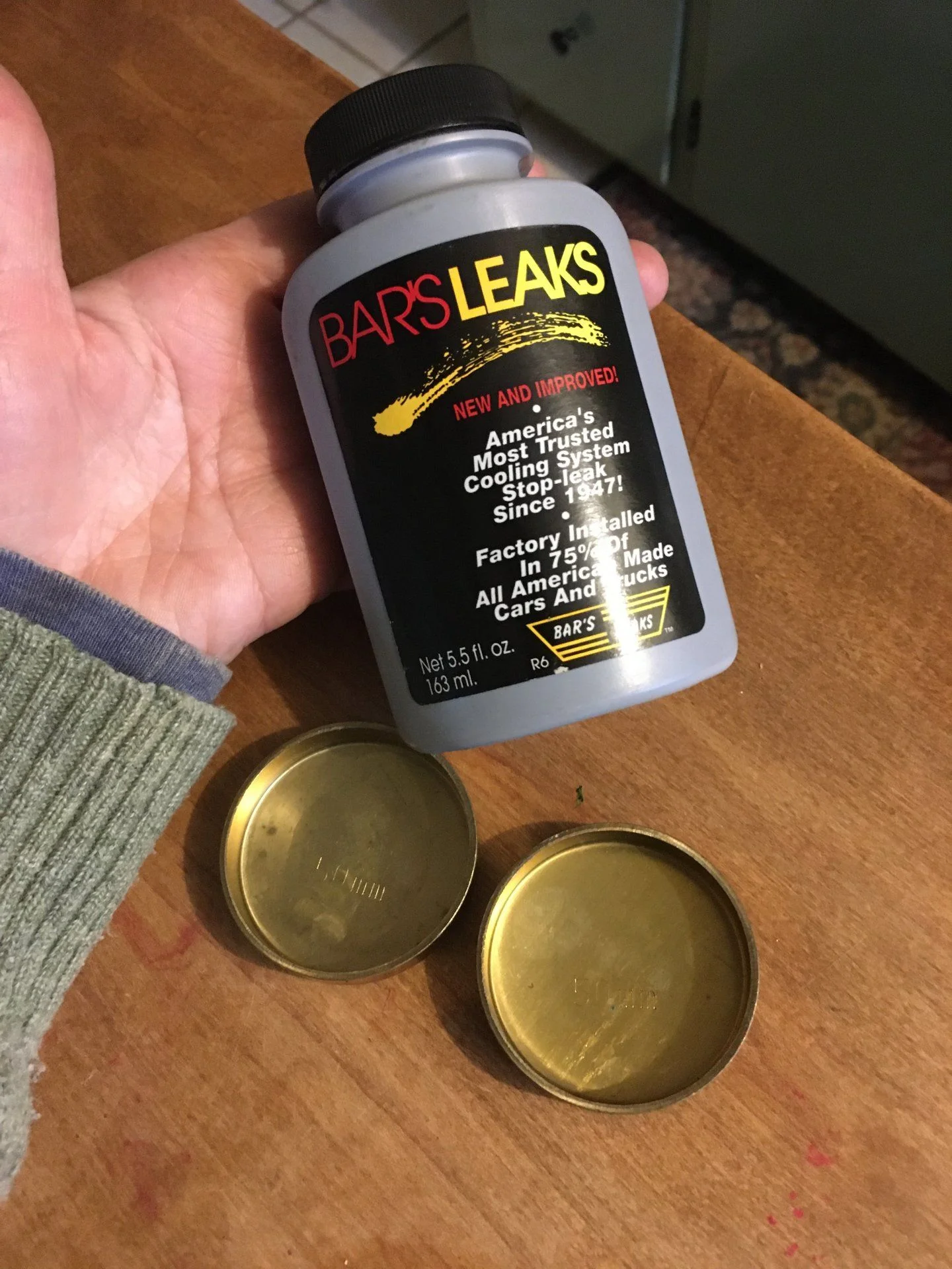

So Richie, the owner of the machine shop, suggested I try this stuff first and just see. If it doesn’t work then I still have my back up plan.
Anyone have pros and cons on that stuff?
Found this old thread from 2010. No worries guys, I won’t do it w/o really thinking it through.
Long years ago, when I was young and a cheapskate, I tried Bar's several times in various cars. All it did was make a big mess, and it never did plug even a small leak in a radiator. I wouldn't put that sh!t in a new motor, or an old one for that matter. After all the work you've put in on that motor, don't scrimp now; fix it right and sleep better at night for a long time.
Thank you. It’s going to the trash now so I’m not tempted.
A buddy of mine put some in his 22RE. A few months later he needed a new heater core, new radiator, etc. He might as well just cracked a couple eggs in there for all the good it done.
