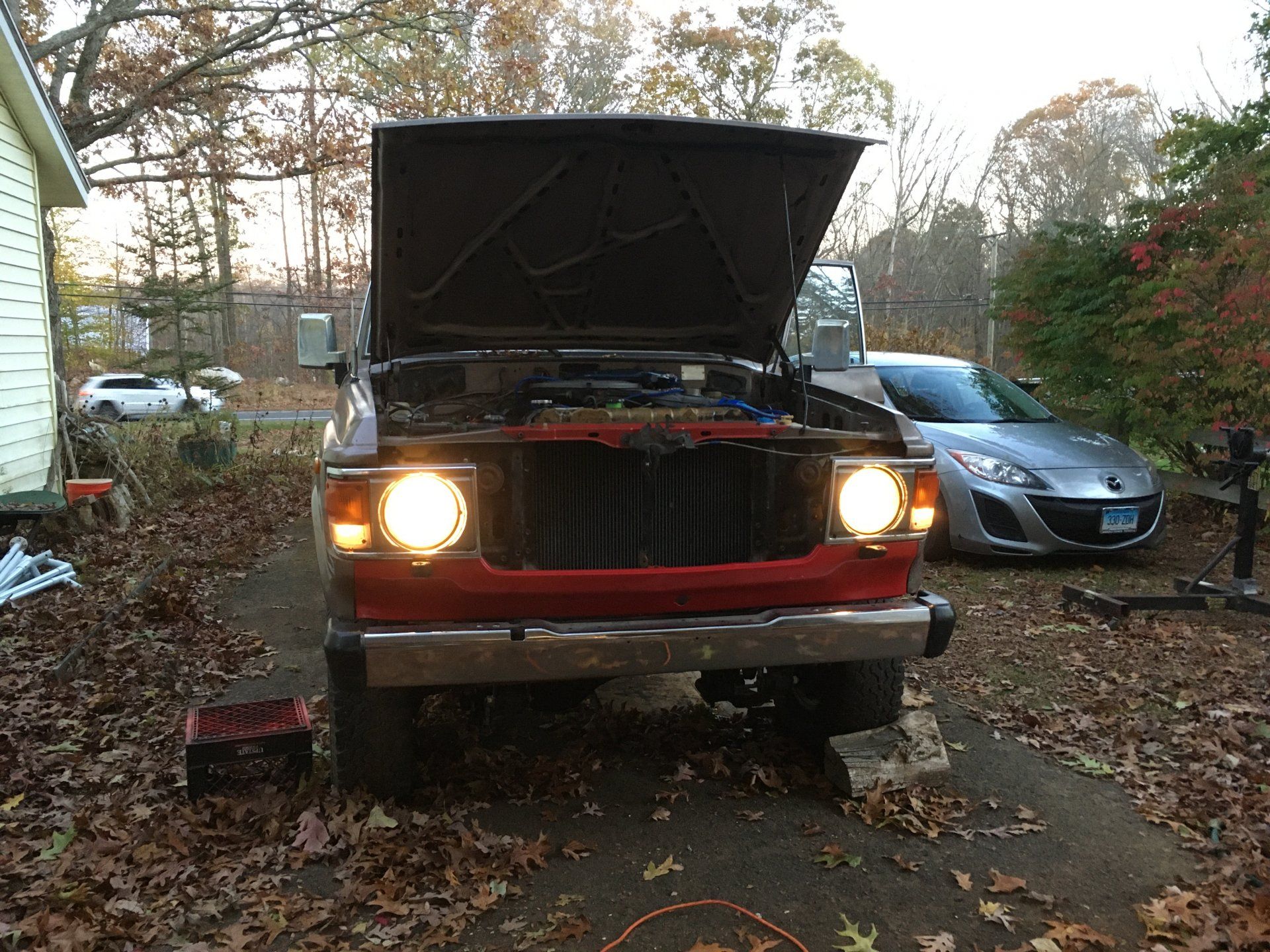

Added battery and have lights. Driver rear blinker out and front fast blink. My truck has been notorious for that so it’s prob the connection at the rear quarter as opposed to the bulb.

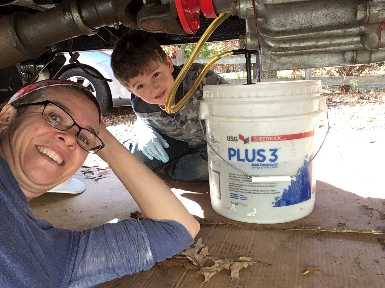

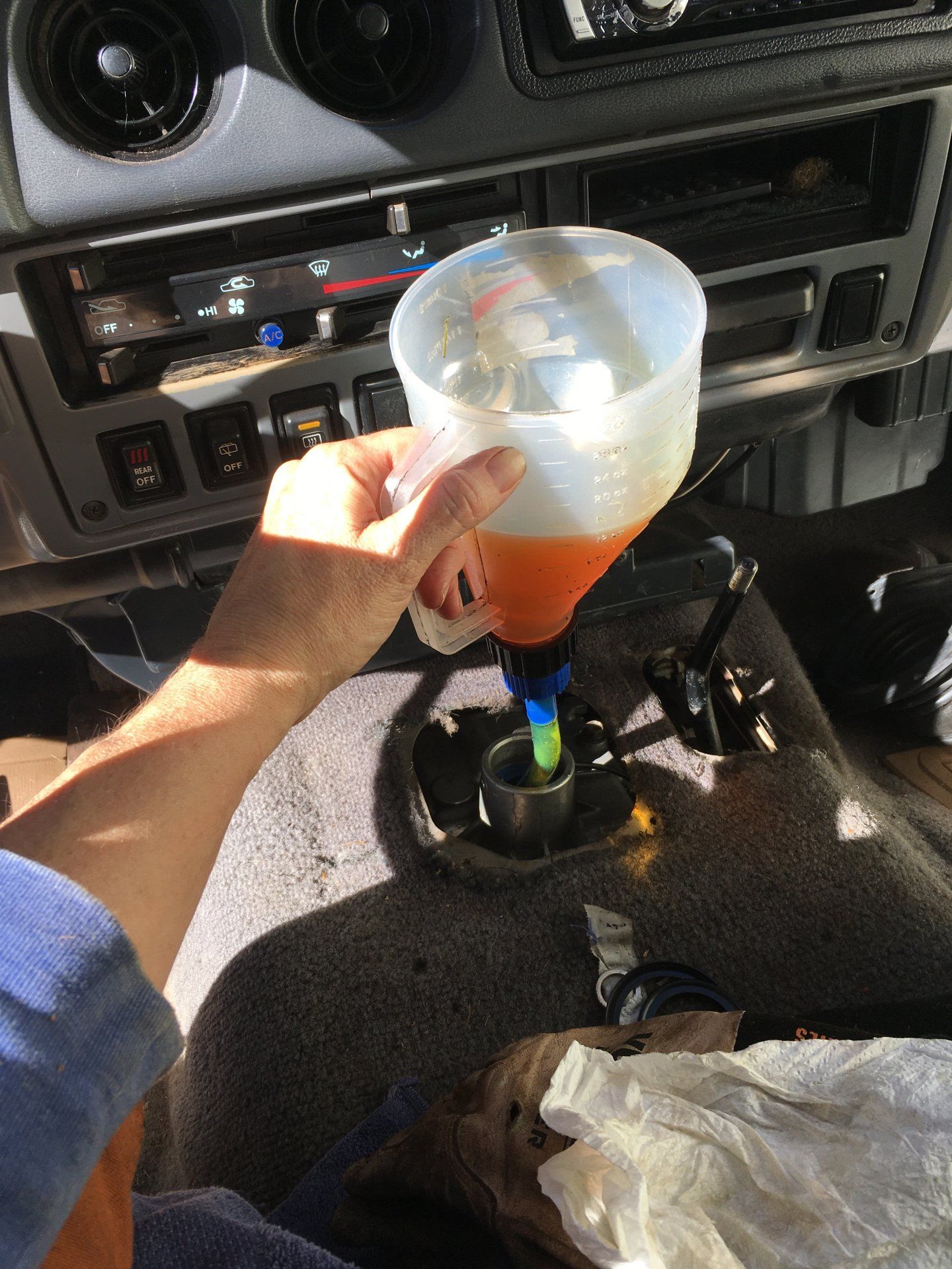

I told him as we finished dinner I’d have him under the truck pumping the tcase fluids in... I might go the extra step to warm the fluid in a bucket of hot water. Kid even asked how thick it is... “like maple syrup?” Just about maybe a smidge more like molasses, not quite. And think I’ll take Casey’s advice and pull the shifter and fill the transmission from the top since I haven’t put the boots on yet.
Maybe a bit overzealous... thought about driving him while showering... another not typical female preoccupation... realizing I may need to adjust timing, adjust valves again, tweak carb... oy.
Pumping sucks. Gravity fill is where it’s at.

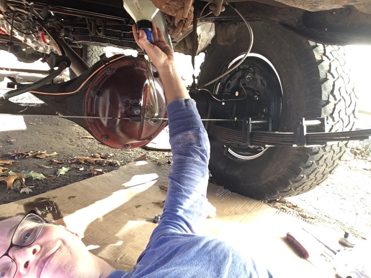

Rear diff filled.
