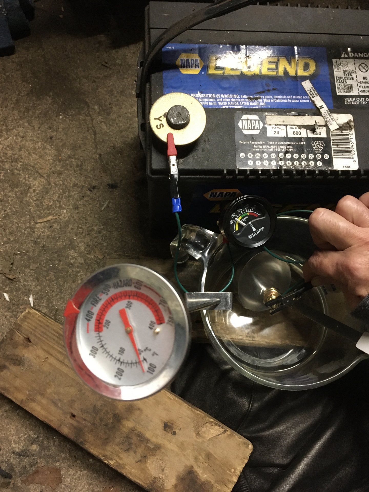

All joking aside... filed up the edges of the in-line Steiger adapter, cut my upper hose and installed. Was walked through heavily by a fav mudder on checking the gauge prior to all the work of installing... (yeah yeah, that would have made far more sense flip flopped). Thankfully it works. Might try it w/ actual boiling water and not just tap hot water that say for a few minutes in the concrete garage floor.
But it definitely works. Measured in the cab for both it and the vac gauge as well. That was my whopping two hours I take while the kid immersed himself in his iPad addiction.
Awkward setup but it appears to be working in some boiled water.
