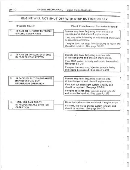

my 1982 BJ60 wont shut off.(God bless her heart)
i took the key part off and used a flat head to do it witch worked for a wile but now that dosent work any more .
dose anyone know what that means.
or dose someone have a diagram and i could just have a swich for my plugs and a push start and off swich like a real race car. . . .
thanks for any input.
manuel
FSM
Heres the page out of the FSM.
Look in the diesel section for full download....
Good Luck.
