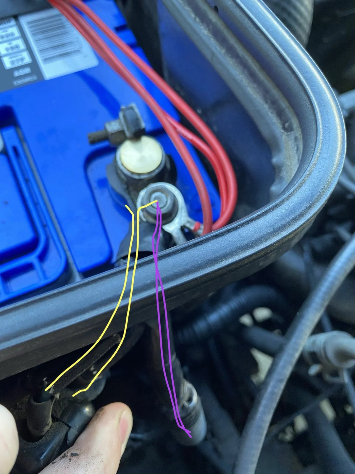

So I was wiring up my new winch when I came across a wiring mystery courtesy of my PO. Considering I am a half-banana tech when it comes to electrical, I could use a trained eye:

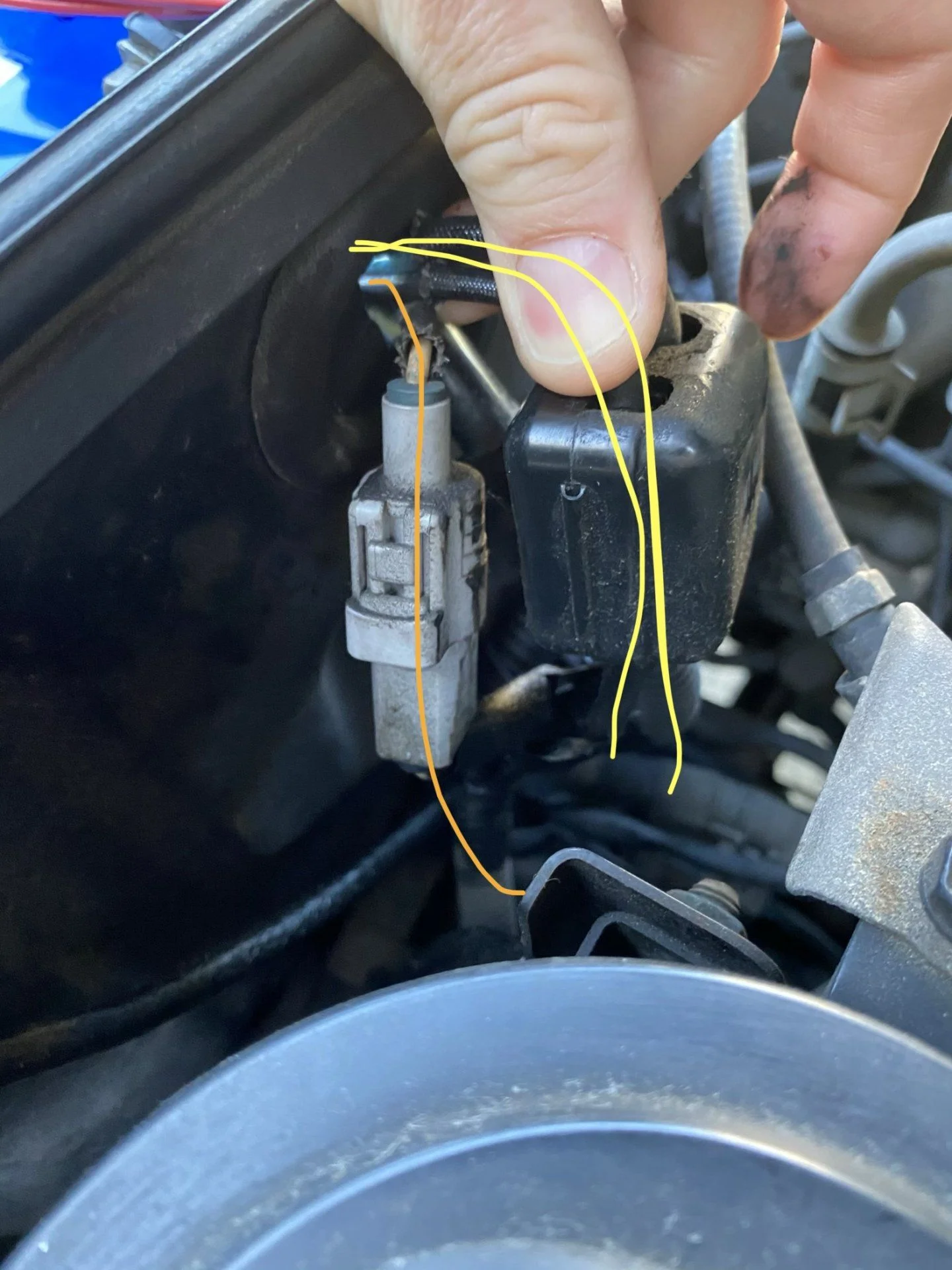

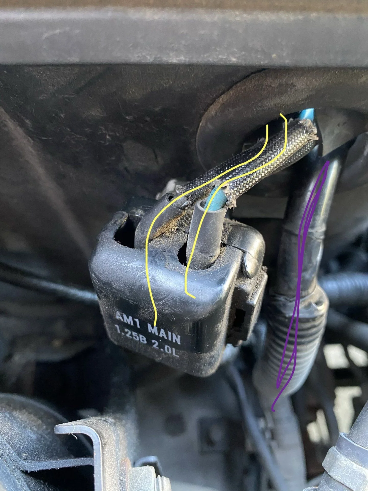

There seem to be two separate cables attached to the positive terminal, marked here as yellow and purple. As you can see, the yellow cable splits through a black box:

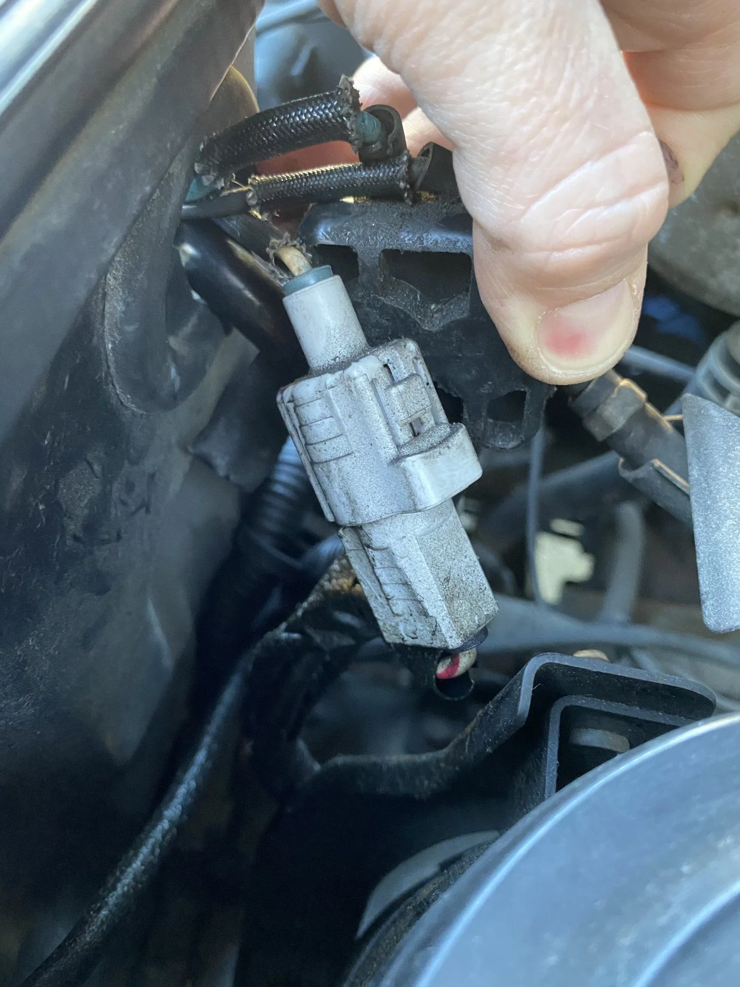

With an additional cable/connector below (ORANGE).
I
I figured the YELLOW harness was related to vestigial trailer wiring, so I disconnected it. No dice: the truck is dead dead without it attached to the terminal. But the PURPLE cable seems much more like a starter cable.
So, any ideas? I’d love to remove extraneous cable, especially as I’m installing @Fourrunner ’s upgraded cables as soon as they arrive, and I can’t currently hook up the winch to the current terminals as there’s no room left on the Terminal poles.

Looks like you just disconnected your fusable links. They are far from being a mystery. Put them back where they were. These are all part of the toyota wiring.
Another view, if helpful.
So this is the stock, factory setup? No extra bits added? I owe the PO an apology.
Yeah thats the factory set up. They are called fusible links, most cars have them, but on newer vehicles they are integrated into the battery terminal in one big piece, but on the 80 and older vehicles they are separate fuses.
