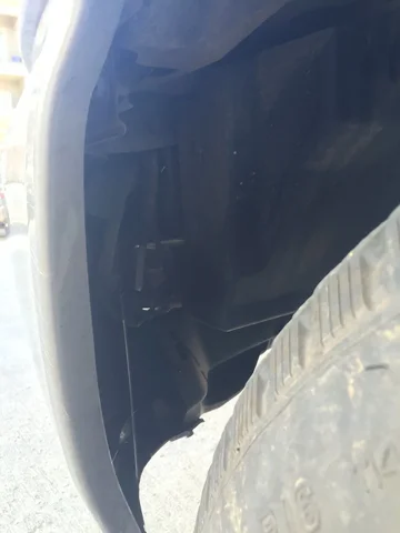

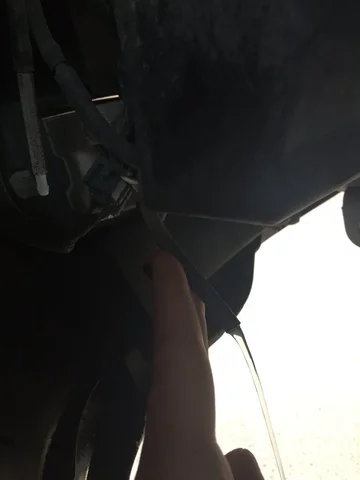

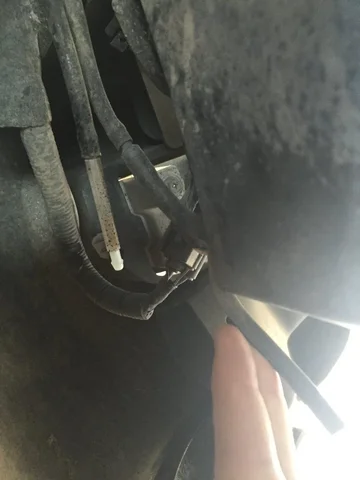

Hey, I'm gunna resurrect this ancient post but this is what google pulled up so it might help someone else!
I Just moved to Colorado and the weather while driving up skiing is freezing my wiper fluid. Hence why I needed to drain all of the old -20 (blue- added by the Yota dealership so I can't verify that it is indeed full strength) and add in the rainx, but I didn't have any medical tubing handy to siphon it out so I looked for another option.
Fortunately I found that at the bottom of the reservoir there is actually a place where you can disconnect the lines and just simply let gravity do the work and drain the whole thing.
Im including pictures because I know this is a bit vague.
Hope this helps!
