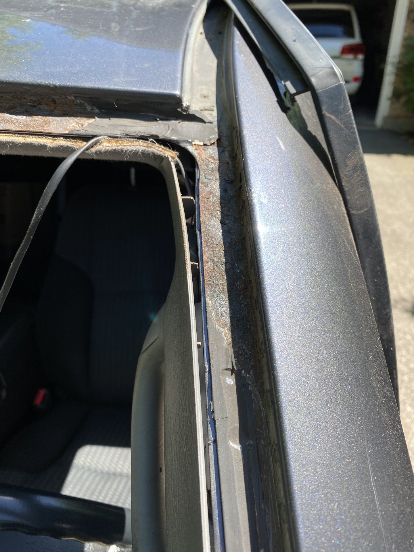

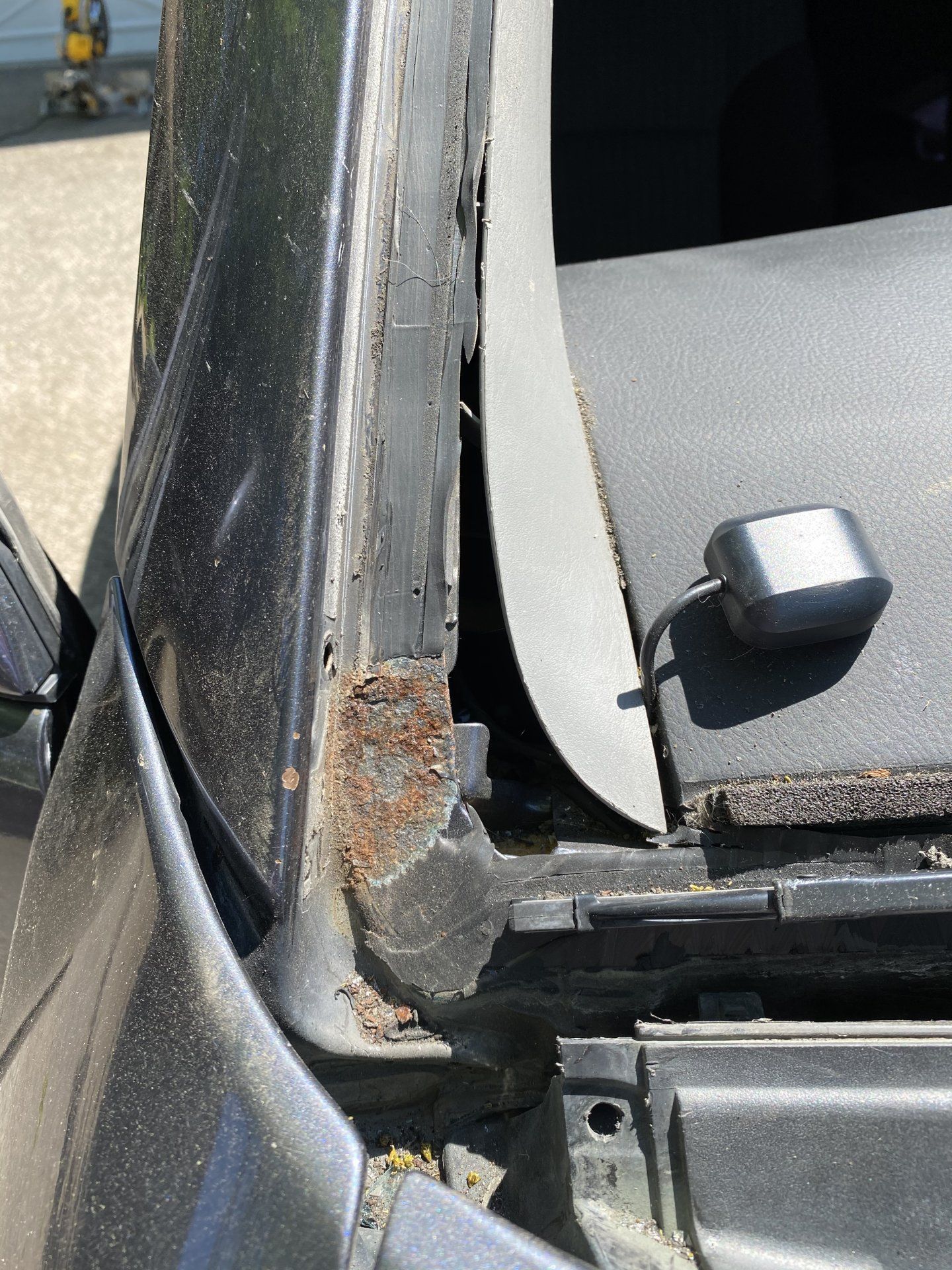

Stay the **** away from Safelite. They replaced the windshield on my 4Runner when it was 1 year old. This is what it looks like 10 years later.
