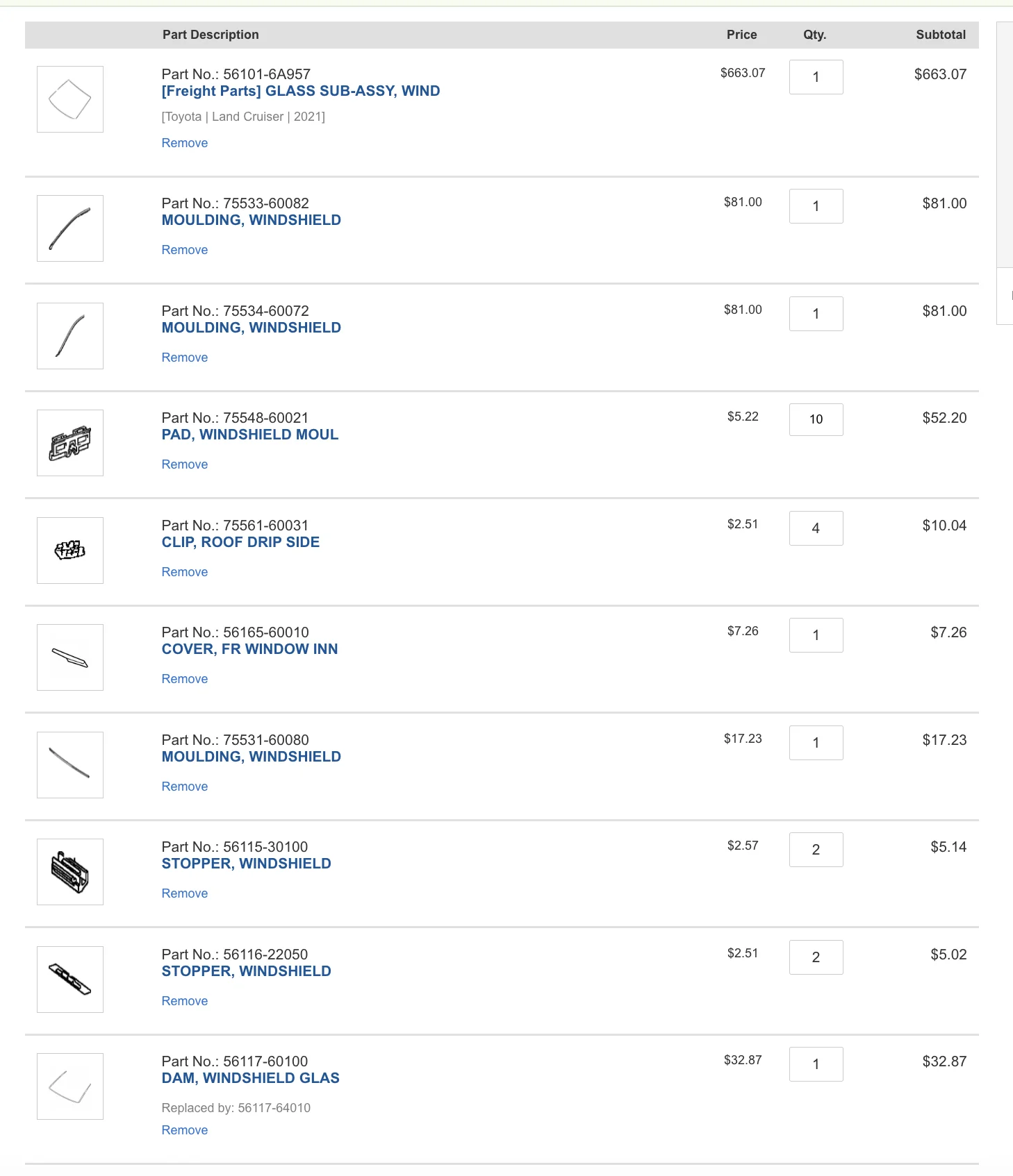

This is what my parts list looks like. I also am thinking of ordering 56117-60100 which is the dam glass adhesive
I had that part on hand but my tech didn’t use it. He said it wasn’t needed when there was an existing bead of adhesive that they cut to remove the old panel.
It isn’t super expensive though.. in case a tech did want it.
