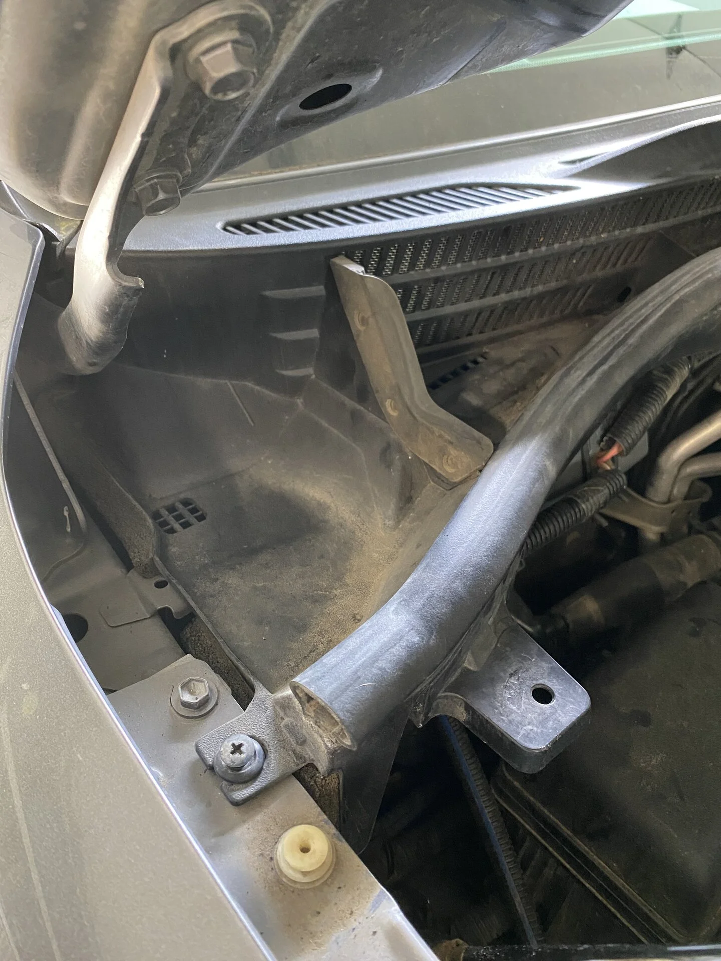

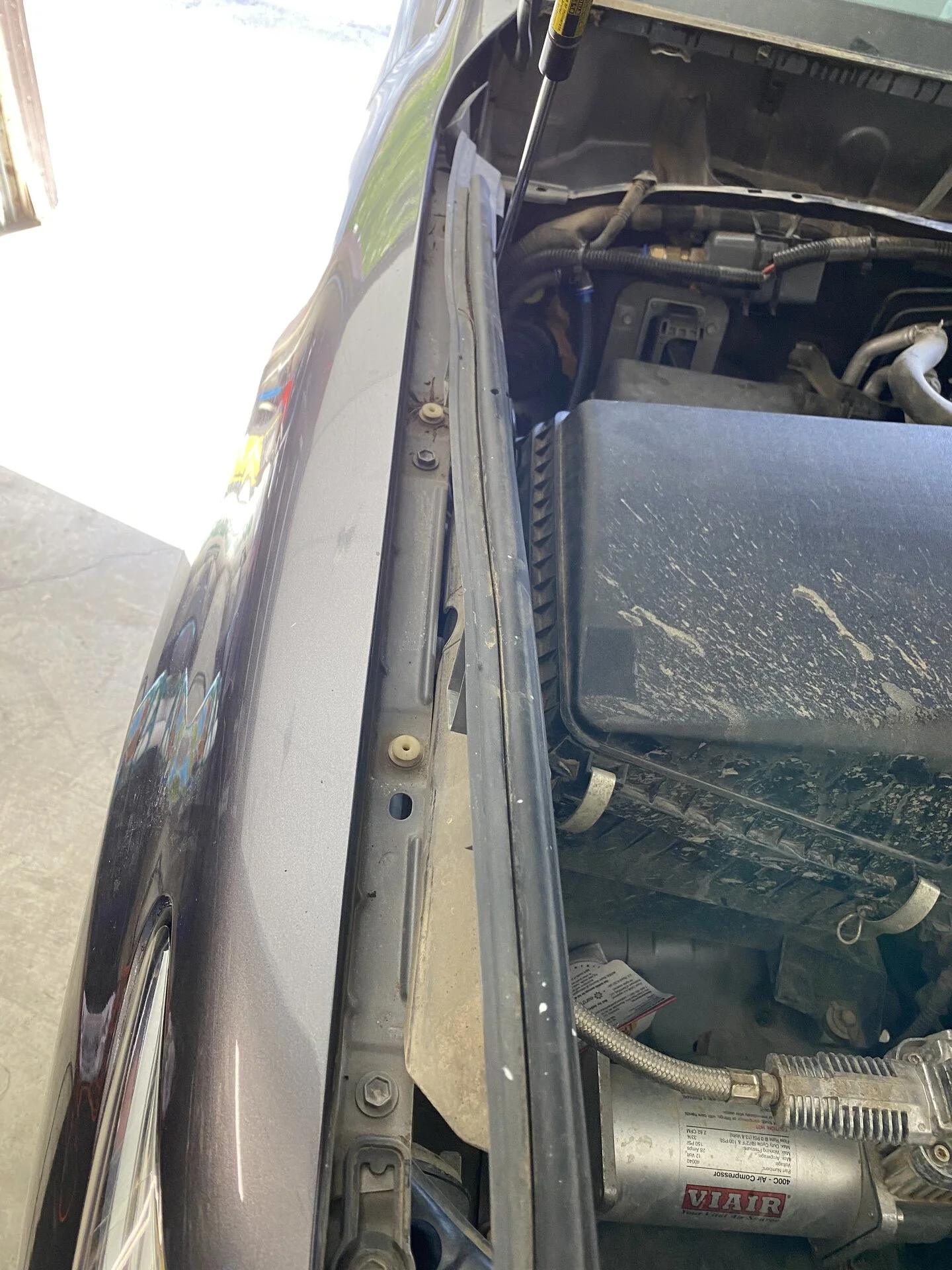

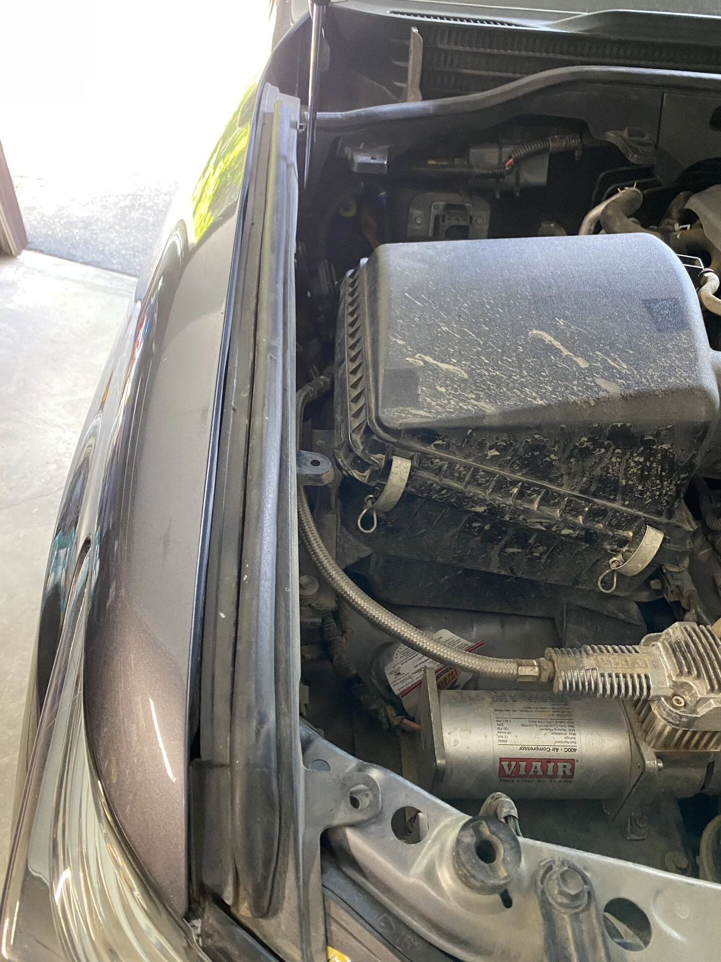

You will need to remove the trim pieces on each side of the engine bay, then you can remove the cowling:

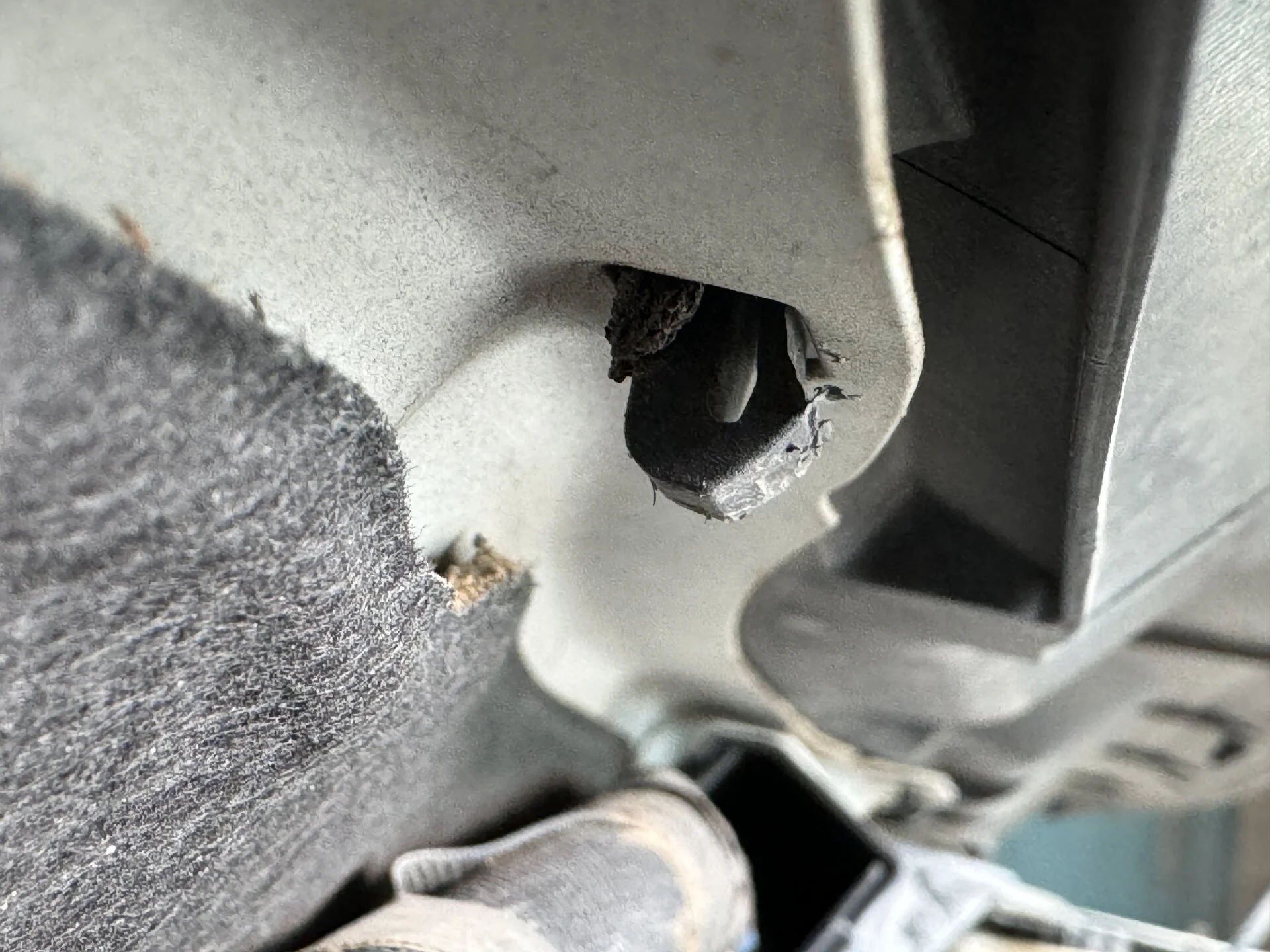

There are also a series of small black tabs that protrude through the firewall that if you release correctly will hold the cowl in place better once it’s back together. Lots of people break these during removal.

So, I tried to pull the nozzle up through the cowl; bad idea for 2 reasons. 1), it would never fit and 2) the hose is so short there is no way you could put it back together. Anyway I took it apart today . Slid the side pieces of trim off the plastic studs fairly easily, unhooked the washer hose on the drivers side of the cowl, removed wiper arms, couldn't fully remove cowl . I tilted it back towards the windshield enough to pull the nozzle, cleaned nozzle with clr and sprayed warm water with a 60cc syringe and some windshield washer tubing until it was spraying a nice fan. When I went to hook it back up the cowl lifted all the way off. I noticed one of the small tabs was broken/missing from the passenger side of the cowl. I don't know if I did it or not, I know the windshield has been replaced at least once. Went back together fine, broke one white plastic trim stud trying to slide side piece on. Drivers side nozzle is exactly like it was before I started, lol. Long way to ask, but how do you release the trim tabs that protrude through the firewall?
Long way to ask, but howdo release the trim tabs that protrude through the firewall?
I haven't had mine off yet, just seen the tabs and people write about it. But going out and looking at my tabs, it seems you just push rearward with a flat-blade screwdriver and lift the cowl upward.
Mine are a little marked up because this rig has had two windshield replacements.. fortunately none are broken yet.
