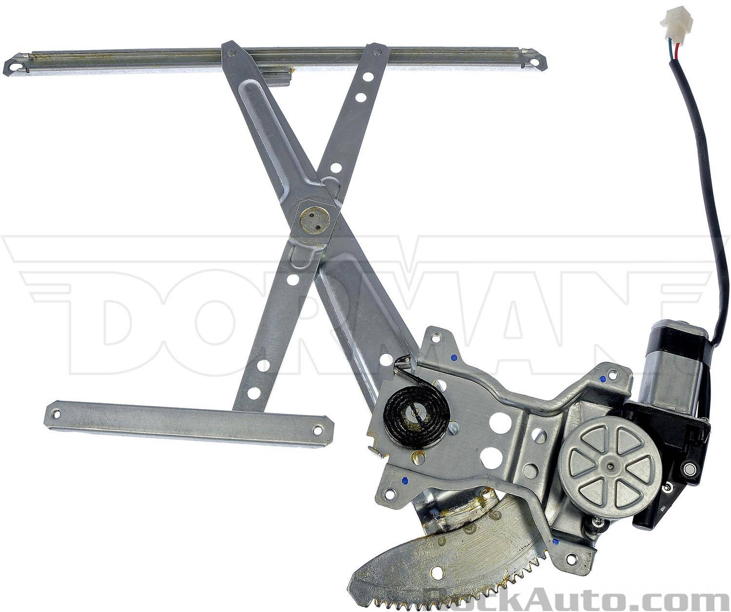

Replaced them with what? The OEM motors have long since been NLA.
RockAuto has the motors and with and without the assembly from various manufacturers.
Aftermarket ones from rock auto and napa. Would definitely do OEM if I could have, but as you said, they've been nla for quite some time.
I slightly misspoke, they did improve the window speed, but VERY SLIGHTLY and in the case of one window fixed an intermittent issue where the window wouldn't respond to input from the controls on the door or from the driver's door
I just did window runs (OEM) and Dorman regulators with motors (Rock Auto). Window speed has increased dramatically. I did adjust the regulator allignment which helped as well.

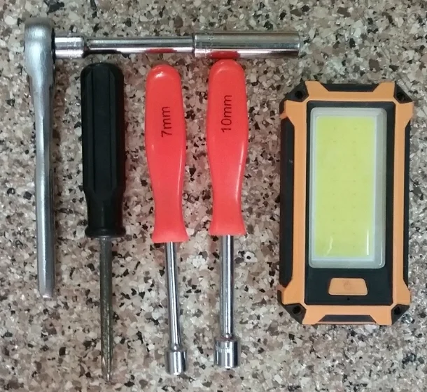

This was a super easy 🍌 mod, the hardest part was getting the plug oriented correctly to plug it in, because you can't see much under there. Simple tools, and a 15min job:
