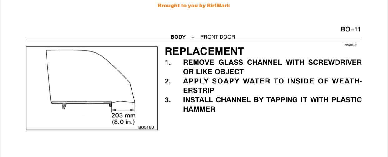

I would make sure the window glass is adjusted to spec before installing the rocket. I think the guy in the video adjusted glass and installed new runs judging by how smoothly that window opened and closed. I’ve had my rear glass pull out of track by the weak factory motors when they were out of adjustment. The extra power would definitely pull them out more quickly so be aware.
Adjusting the glass and new window runs made the windows work adequately for me in all seasons. But that window speed is amazing and tempting.

Two years ago, I had new OEM window runs, window motors, and regulators installed in my '95. The windows are much faster than they were before, but nowhere near as fast as the demonstration in the video.

Replace the window runs, make sure everything is adjusted properly, and it will work fine. This is snake oil and a bandaid.
Runs are a big part of it, though if your regulator and motor are worn out, they make their own contribution. I'm also sure he's right about low voltage getting to the motors - 30 years of corrosion makes a difference. That said, for $300, I can afford some REALLY good contact cleaner.

Clean out the 30 year old grease and lube the motor and rotating assembly. Works wonders.
