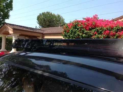

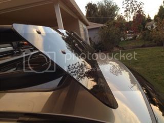

I made a couple of prototypes and tested them when I made mine. A few things to save you the time. First, use 1/4" acrylic instead of polycarbonate. It's cheaper and actually scratches a lot less (car wash, etc.). And you don't need the extra impact resistance, imo. Don't go thinner- unless it's fully supported it will flex too much with the wind. Also, try to get it to within 1" of the roof to completely cut out any noise. Mine is all but silent.
Good luck!

Tap plastics for the material. I got the tinted, but they have clear also.

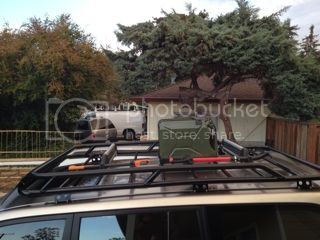

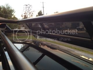

I customized the rack to have flat mounting areas along the front. The upper basket front is offset from the lower, and the flat stock I just welded between them. SS hardware and rubber washers to keep the plastic from cracking. I made the prototypes out of masonite to save screwing up the plastic. I'll try to find a few more photos.

OK so the custom wind fairing for the roof rack is up. Still some whistling with the sunroof open.
Wondering if adding a sunroof wind deflector will help...
