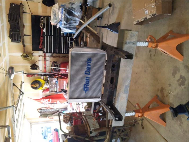

I have done just about every different mod with the stock radiator. I upgraded to a 4 core with a fixed fan and a tauras electric fan and the best mod was go with the biggest radiator and a good fan clutch. On my new build i am going with a ron davis with dual electric fans, but that was hard on the wallet. Get a good clutch fan and 4 core and see what that does.

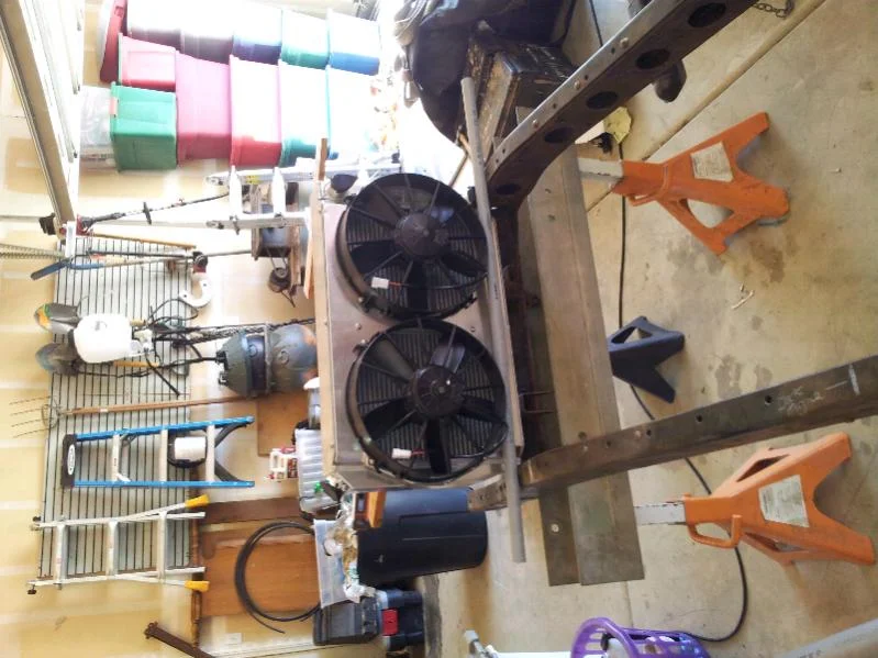

Took significantly longer (to get the radiator) than it was initially supposed to, but I have the 4-core radiator installed, along with an Derale 2-speed electric fan/shroud combo and accompanying controller. Engine is mounted too far forward for anything larger in an electric fan. I've 4" between the radiator and the water pump, the Taurus fan is just over 4", as are the vast majority of the high CFM (3000+)
The whole setup was a little spendy, unfortunately, but it does seem to have rectified the problem. Nice clean setup too, an I am satisfied with the performance this far.
Very clean, looks very nice $$$, have you had it out in the recent heat ???
Indeed I have, both with the winch on the front and off. Temps, while hammering on it on the highway, were 205 in both cases. Keep in mind my temp sender is in the head between cylinders one and three, and when you have your foot in it that position will read 20 degrees higher than the intake manifold position.
