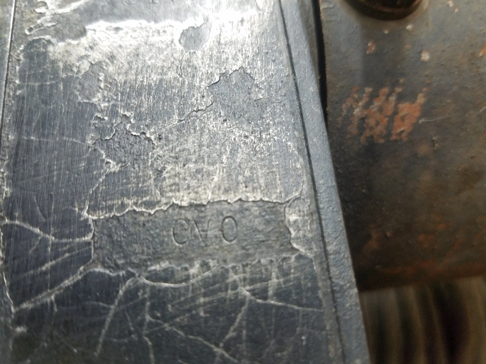

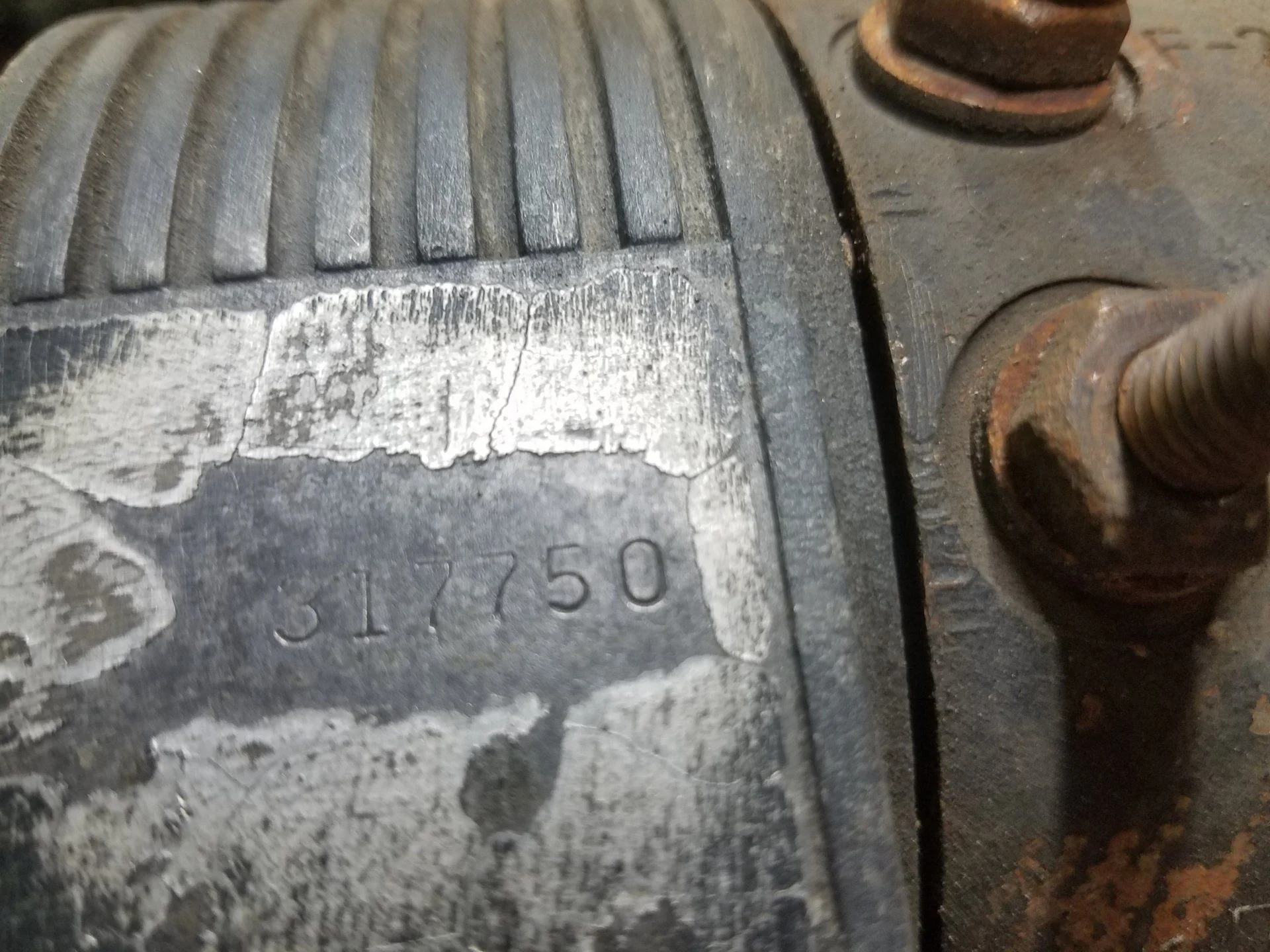

That's the only number I can find on the winch I need the brand and the model so I can buy a motor the stator is grounded thanks

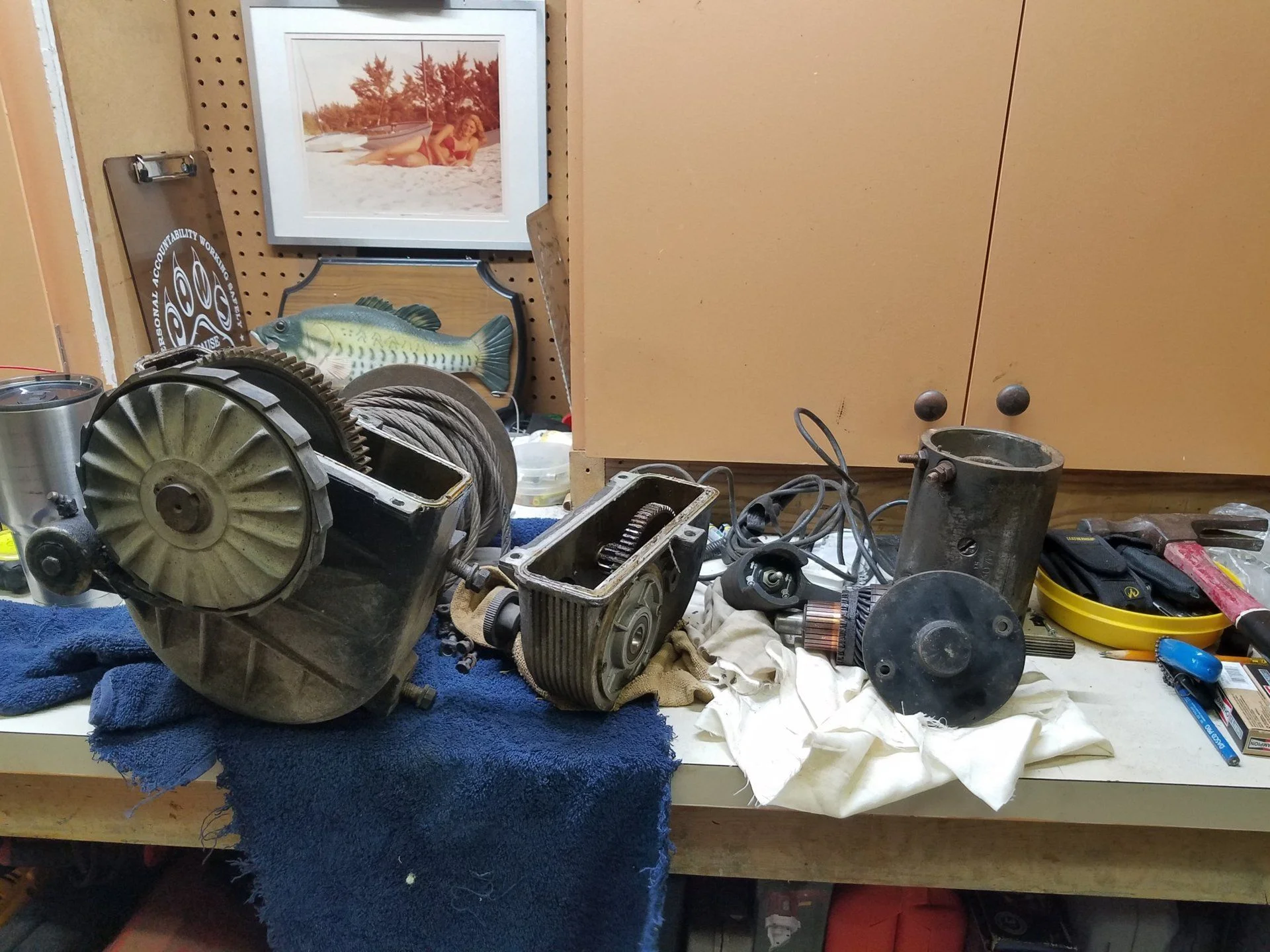

A photo or two would help.

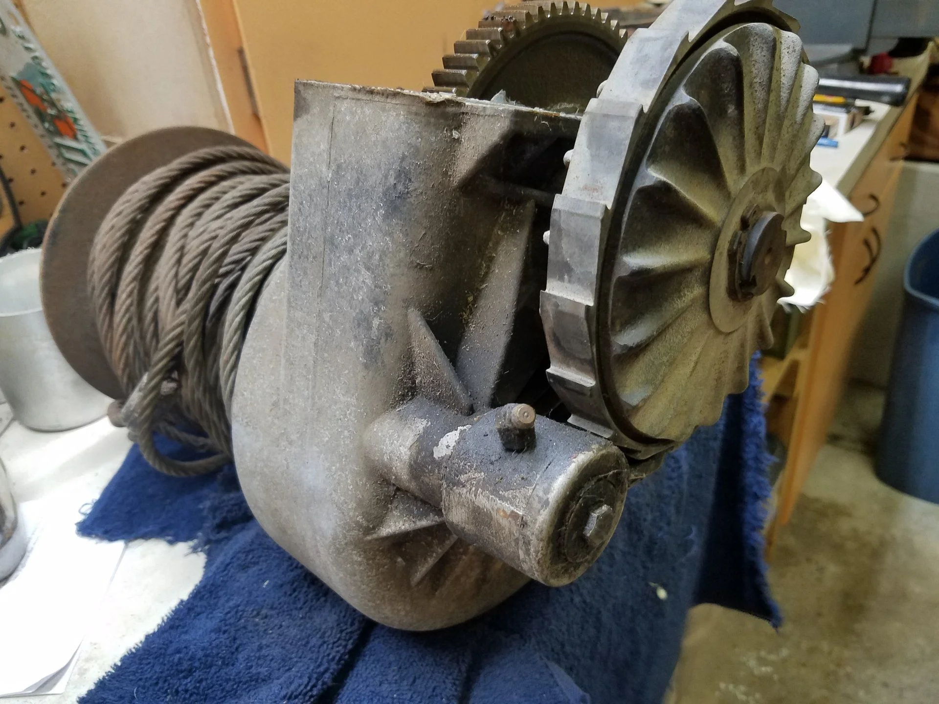

how can you tell
The castings, the external brake, the spur gears, the clutch knob, etc.
It's an 8274, it was made on March 30, 1990. It's rated as an 8,000 lb. winch but it will pull quite a bit more than that, especially if you put a later higher-hp motor on it.
A great motor to replace the original is the one made for a Warn 9.5 XP winch, Warn part # 68608. It's a 6 hp motor; the original 8274 motor is like 2.5 hp if i remember correctly.
