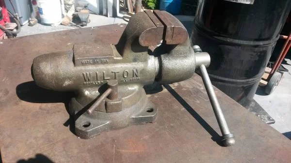

Here's the old one for sale

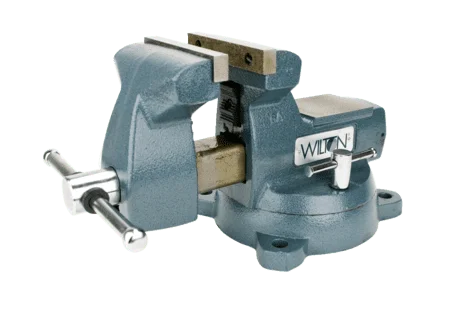

Mechanics Vise 6" Jaw with Swivel Base

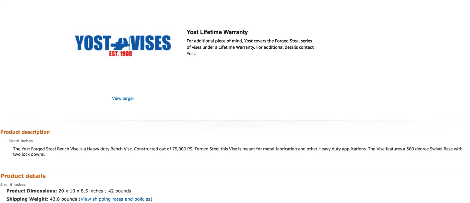

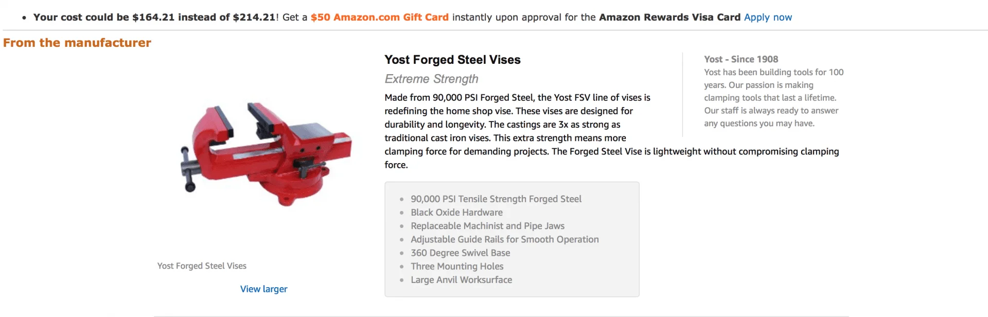

Although on the same page, on Amazon I already found a discrepancy:
90,000 vs 75,000 PSI

I hadn't noticed the contradiction on the Yost listing (because I never considered buying it), but I'm about to report it to Amazon. Thanks.

I have a vintage Wilton bullet, got it mostly for the nostalgia of it, I love it, but honestly, I would not spend $700 or so for a new one. Most vises will do fine for routine holding jobs I would think.

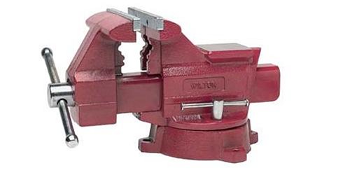

and this Wilton 675 (5.5")

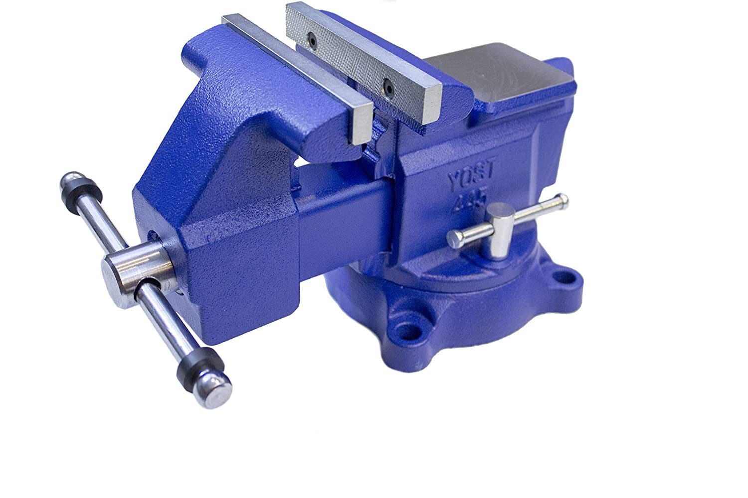

Those vises are identical; just on different bases again, and the Yost has rubber silencers on the main handle.
