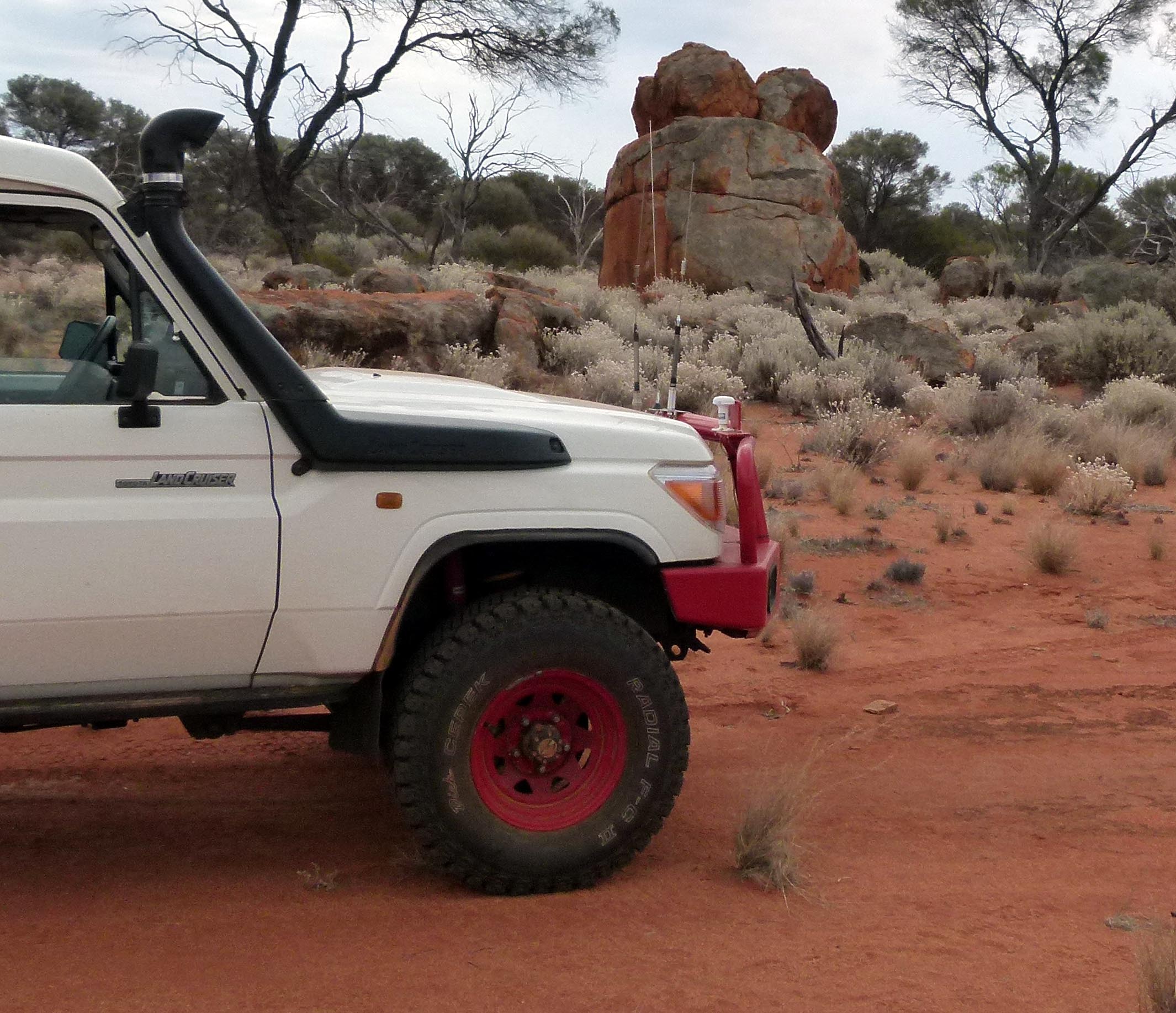

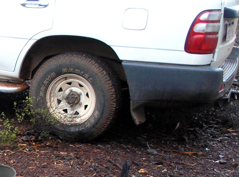

Yep, mate's 105(1HZ) - definitely 5 bolts:
and another mate's 78 (new style with the tdi v8) - also 5 bolts... He likes Red :)
cheers,
george.
