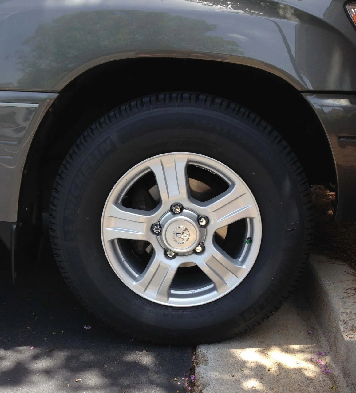

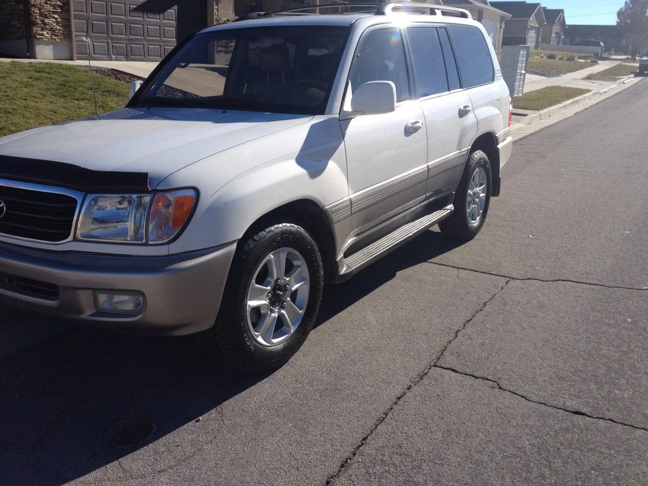

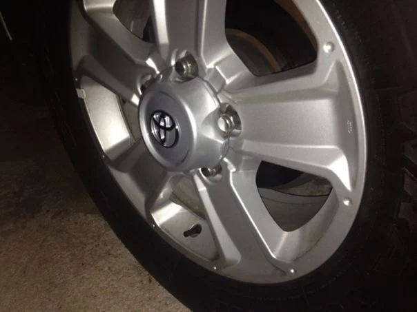

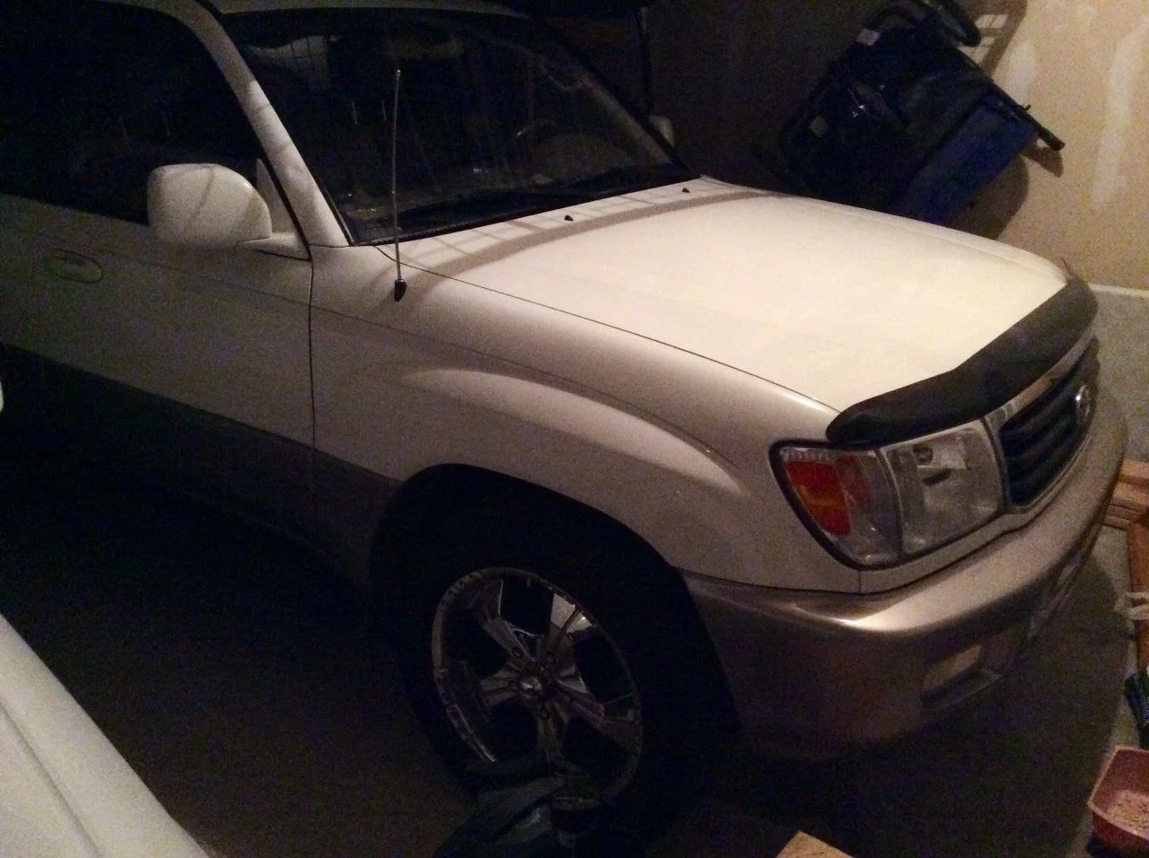

I ended up getting the 18 inch Tundra wheels - from the '07 and up years.
I have an LX but from my research here only the LC center caps fit.

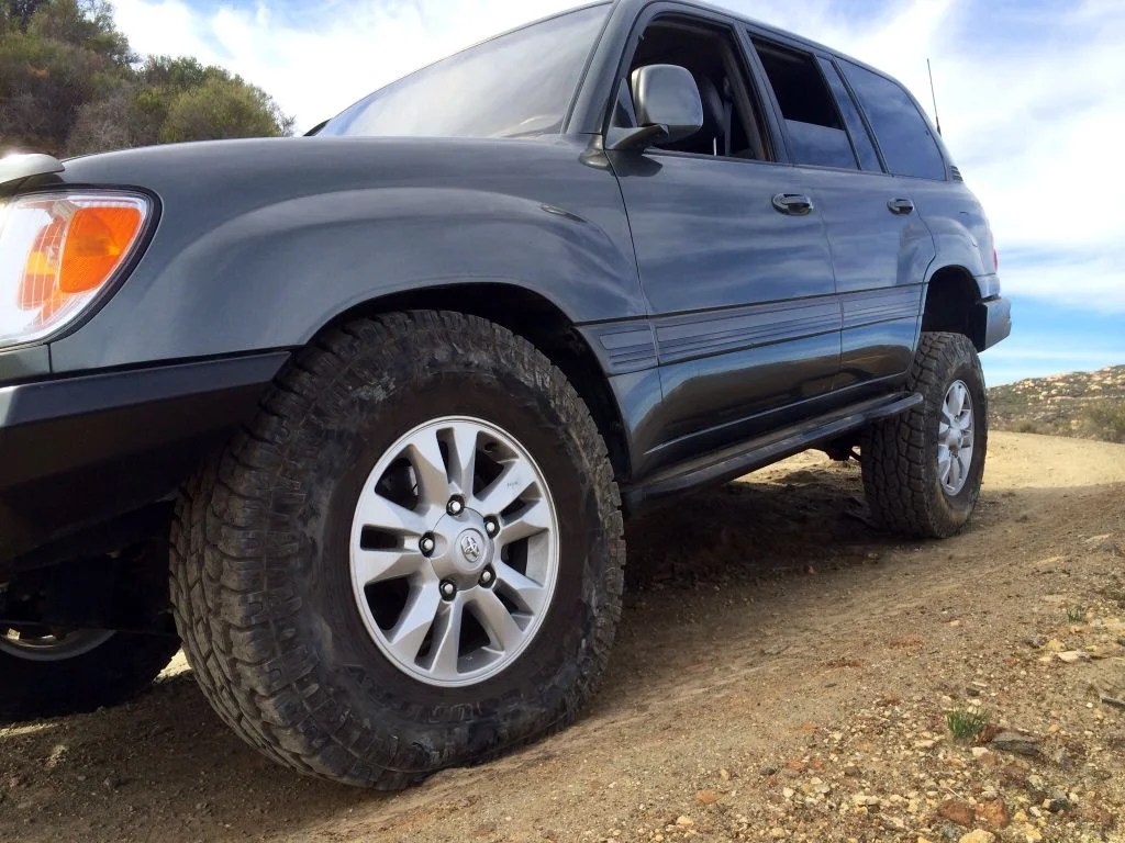

I like the new look - the 18's look much better than the 16's - especially with the new Michelin AT2 285/65/18 tires.

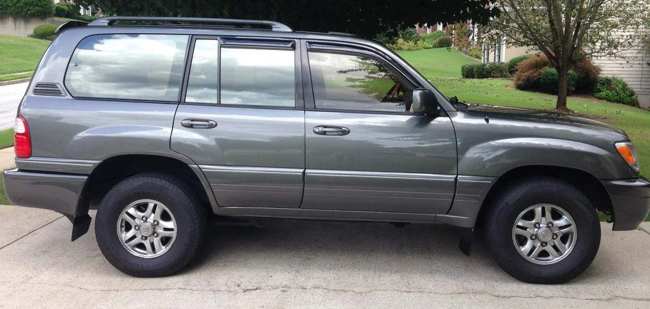

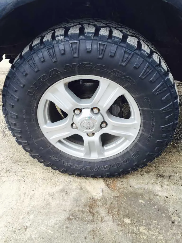

Here is the old 16 inch wheels
And with the new 18 inch tundra rims
The stock center caps from my 99 TLC fit them fine. The truck handles way better with 18s, kept the 16s for offroad. :)

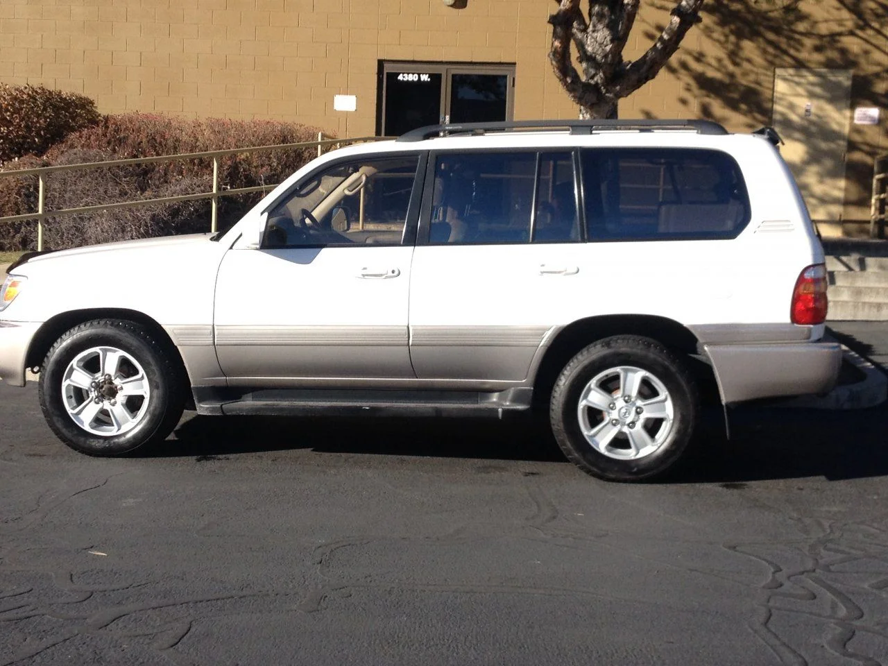

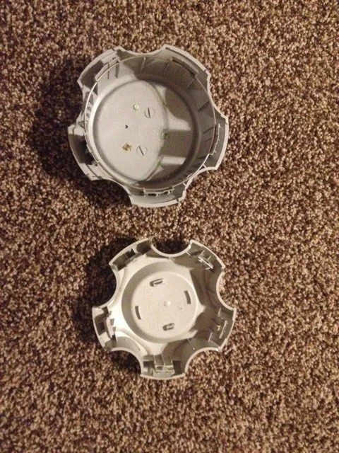

Old (sorry for the pic quality)
New

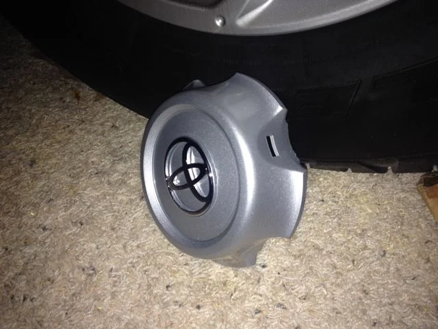

I made the assumption that the wheel caps for an older Land Cruiser ('99) would fit these new wheels.
You can see from the pictures that they are close... But are too tight.
Any idea if there are other types of "deep" caps that will fit these wheels? Any other suggestions other than boring out a spot to make the shallow caps fit?

So I picked up a set of '09 18" Tundra wheels with very young tires for a steal on Craigslist. I plastidipped them, used a hole saw to drill out the centers of the front center caps to accommodate the longer grease cap (as others have done with success) on my '03 100. They look great, but the front center caps won't go on even though the grease caps aren't impeding them. It looks like they're getting hung up on the hub bolts (not the lug nuts). Am I doing something wrong? Anyone else run into this issue?
you will need to buy the center caps off the lc 18 inch wheels. ATTACH=full]1045569[/ATTACH]

strange because it seems others have done the same swap.....
I used the lc center caps off the 16s that fit, but loosely. Every Time I went mudding, I ended up loosing one or two each time until I bought the center caps that were made for the 18s. I never tried cutting out the center of the tundra center caps. I have been mudding many times with the center caps made for the 18s lc on the tundra wheels and haven't lost a center cap yet. I haven't tried cutting out the tundra center caps. I am sure you could make it work, but know for a fact that the 18 inch center caps made for the lc work great for the tundra wheels on my lc. The 16s, not so much.
