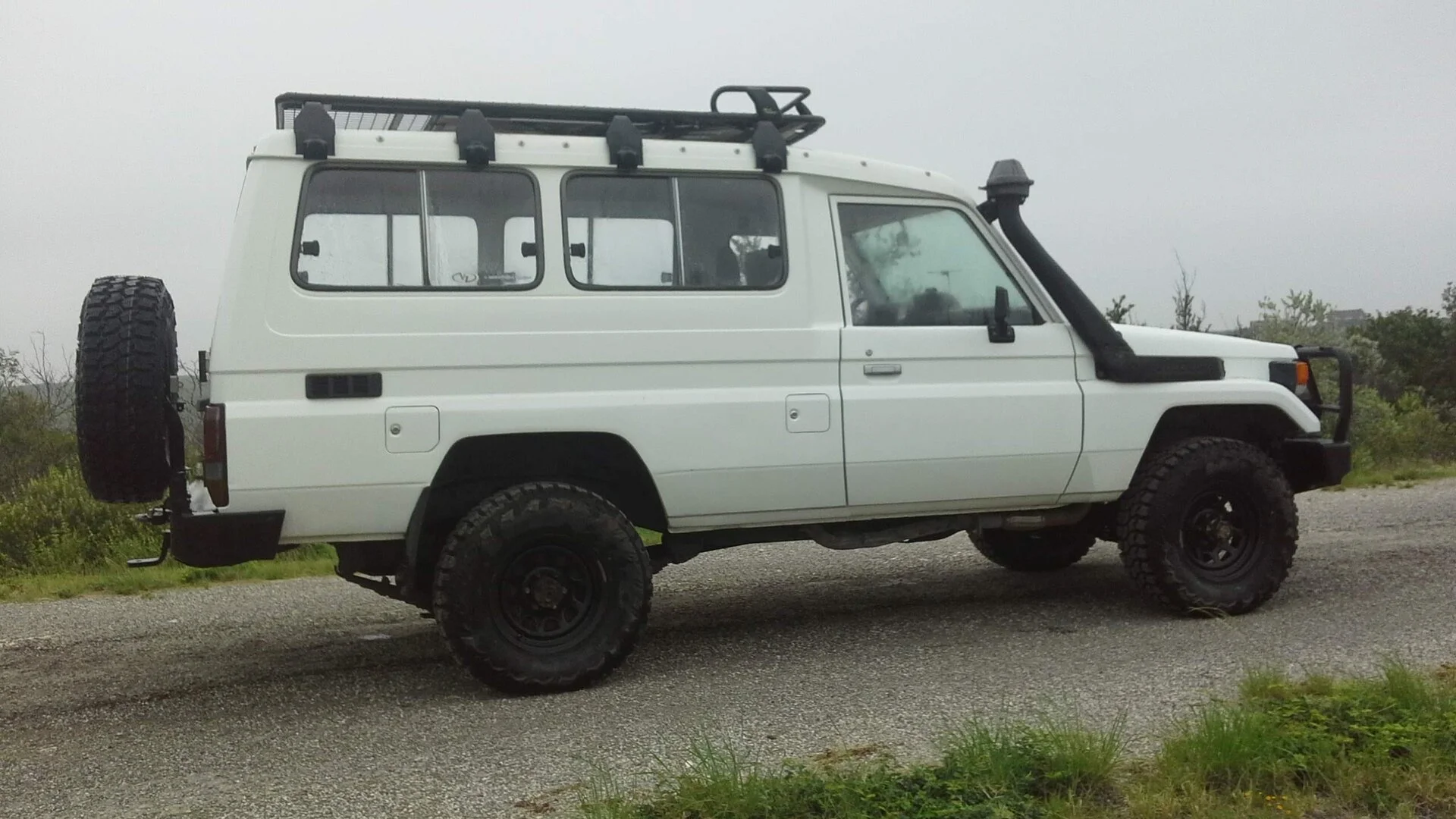

I have an Ironman rack on my 75 and I like it a lot. Heavily built, solid as a rock. It's not truly full length, it goes to the break in the roof line. Still pretty long. I know they make some full length racks of different styles, not sure about fitting on a troop carrier.
I would buy an Ironman rack if this one hadn't come on the truck already. I don't like their garish lime green livery but the stuff is a good value. For one thing it's actually welded together out of tubing, not that modular screw-assemble stuff that is the vogue now.
The 78 series roof racks (frontrunner and others) will fit a 75 series- same roof size.
