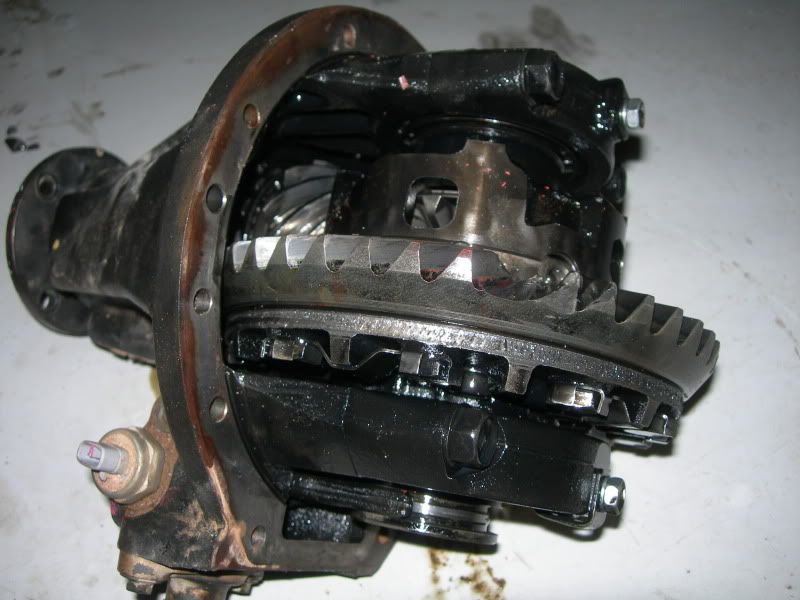

After grenading my rear dif last weekend, this may have been the culprit hill, but it just started making a funny noise on the way home
I took wikid to Toyota.
I have 79000+ on the odometer but I have the extended 100,000 mile warranty. Unlike Toyota, after the warranty company saw all of my mods, they wanted it torn down before authorizing my repair. The feeling was, they would deny it. The rub is, the tear down cost was about 400 bones. then the new dif from Toyota would have been about 1800
So here's what I decided to do. I limped my truck back from the dealership, got on the phone with East Coast Gear Supply Drivetrain Specialists East Coast Gear Supply and ordered 2 built 3rd members front and back with 4,56 Nitro Gears. I think I will just do the install myself and try to do a little write up. For less than the cost of 1 dif from Toyota.
My thinking was, even if they warrantied it, I would still be stuck with factory weak 3.73 gears. I needed the upgrade with 35's anyway, so why not kill another birdie while I got greasy?

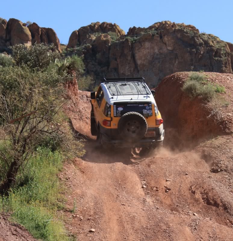

Nice video Yep you get some wheel lift on that hill.

Hey I played there on Sunday. Smashed my cat and killed an o2 sensor later in the day. I had never tried going down this so I figured I'd give it a schotts.
heres a vid
YouTube - FZJ80
Shoot, I cam down that last month without lifting a wheel. Shotts even has a video of me on his Smug Mug page. John

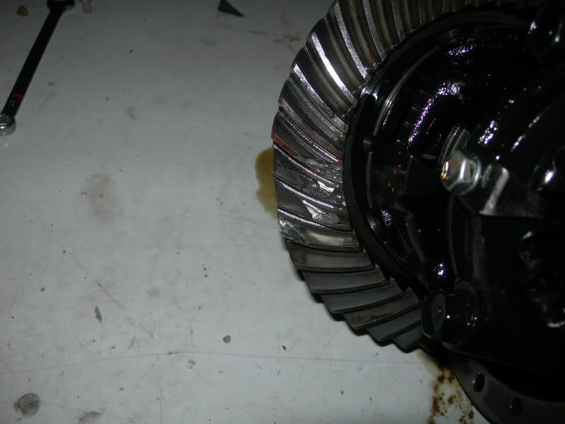

From your direction it sounds like a 5 minute job. I did tear down the rear today and found the troubled spot
I may have the front torn down by the time the difs come, later this week
No wheel hop at all. It was a gradual break. It may have started on the middle line at red hill, but never noticed anything to give it away. that is really the only stress at all, from the day. Rose noticed a slight noise, when we came out of the canyon going faster. At first I didn't hear it . then it got a little louder, so I drove it steady and slower on the 60 . I even put it in 4 wheel, to keep the pressure off it. when I got it home I put it in reverse and hit the gas just a bit harder and I heard a small clunk, then I knew it was the dif. When we were on the 60 it almost sounded like a wheel bearing. I actually drove it the next Monday to Toyota, then drove it home when they said, it was 400 to tear it down. So it never really gave up all the way but it was close .
