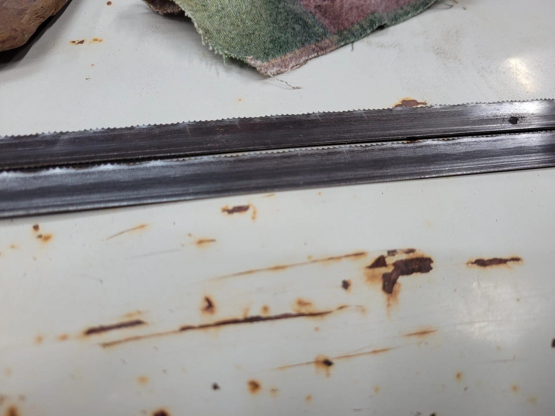

Noticed a couple of the snapped blades in my scrap barrel and pulled them out. I was wrong when I said they snapped at the weld. Looks like the developed multiple cracks, coincident with the wave of the teeth and snapped at one of them.
