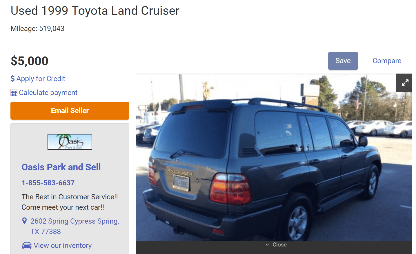

No affiliation to this one. Currently in the hunt for an 80 or 100. Looks like it held up well for over half a million miles!
