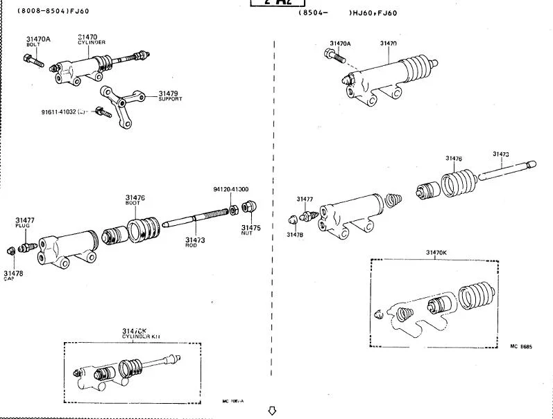

OK I was reading over some old threads and found one that describes a weak spring inside of the slave cylinder in later model trucks. Is this spring absent in my 1983? When I rebuilt the slave there was not a spring inside of it but there was one in the rebuild kit and the fsm so I installed it anyway. Could this be the problem?
It looks like the spring inside the slave cylinder doesn't show up until 4/85 build date. As stated above, the whining you hear when the clutch is disengaged (clutch pedal depressed) is most likely the throw out bearing.

Just an update and a new question. I removed the spring from the interior of the SC and adjusted the pedal and freeplay as per FSM instructions. I replaced both springs, one at the pedal, and the one at the slave with a significantly stronger spring. I also adjusted the push rod until it is as short as it will get. I am still hearing a slight whine when the clutch is depressed but nothing as bad as before. after that was all done I noticed the the "clutch fork"? is able to move a significant amount in all directions (up, down, in, out ,and obviously front to back as tough it is unattached and floating freely. Is this normal?
