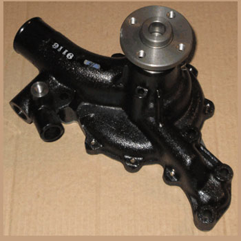

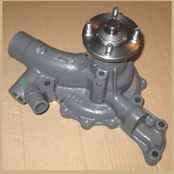

Hello mudders, I'm involved in some pump jeopardy at the moment. I have a Spanish market 3B diesel 1989 BJ-73 which needs a water pump replacement, but I'm not sure which one to order. Mainly, I have found two variations of pumps; one made up until 08/1988 and one made after. My vehicle is a 1989, and I have found that it sits right on the cusp of many mechanical design changes. Here are the pump designs by Toyota;
1) (up until 1988)
2) (after 1988)
Question is, what are the major differences? They look similar with exception of the mounting surface/gasket. Also, if I have option 1, could I upgrade to the redesign of option 2?. Thanks!
I think the major difference is that one design will not accept a viscous fan clutch. You should check to see if you have the viscous. I don't think there are any other critical differences, might have different holes to plug etc but I think these will mount the same way.
Not a recommendation to buy from here but these links show the two different pumps in more detail.
So it looks like my vehicle does have a fan clutch, but all of my technical references indicate that water pumps from 1989 forward are for non-fan clutch equipped vehicles.... This is confusing, as my vehicle is a 1989 model year. Any ideas?
Thanks @Onur ! My statement about no fan clutch after '88 doesn't seem to be true as I do more research. I also finally found that my production date was 03/1989. As can be seen below, 16100-59105 is for pre-88 models.
So, should I go with 16100-59185 instead?

I missed the build issue.
Why didn’t you provide your frame number or VIN to confirm? That will be a better way to figure this out vs talking in months and years.
JT1V0BJ7309004331
My bad, completely wrong on my side. Will change information to reflect correct information.
Doesn’t help I skipped over the crucial build information! Too much multi-tasking.
16100-59187 is the correct part number.
But you might be able to get away with using -59105 if they are the same Aisin number.
If the gaskets are the same part number then I would suspect the pumps would probably be interchangeable.
I’d contact Cruiser Outfitters in the Utah and go in the Aisin direction.
