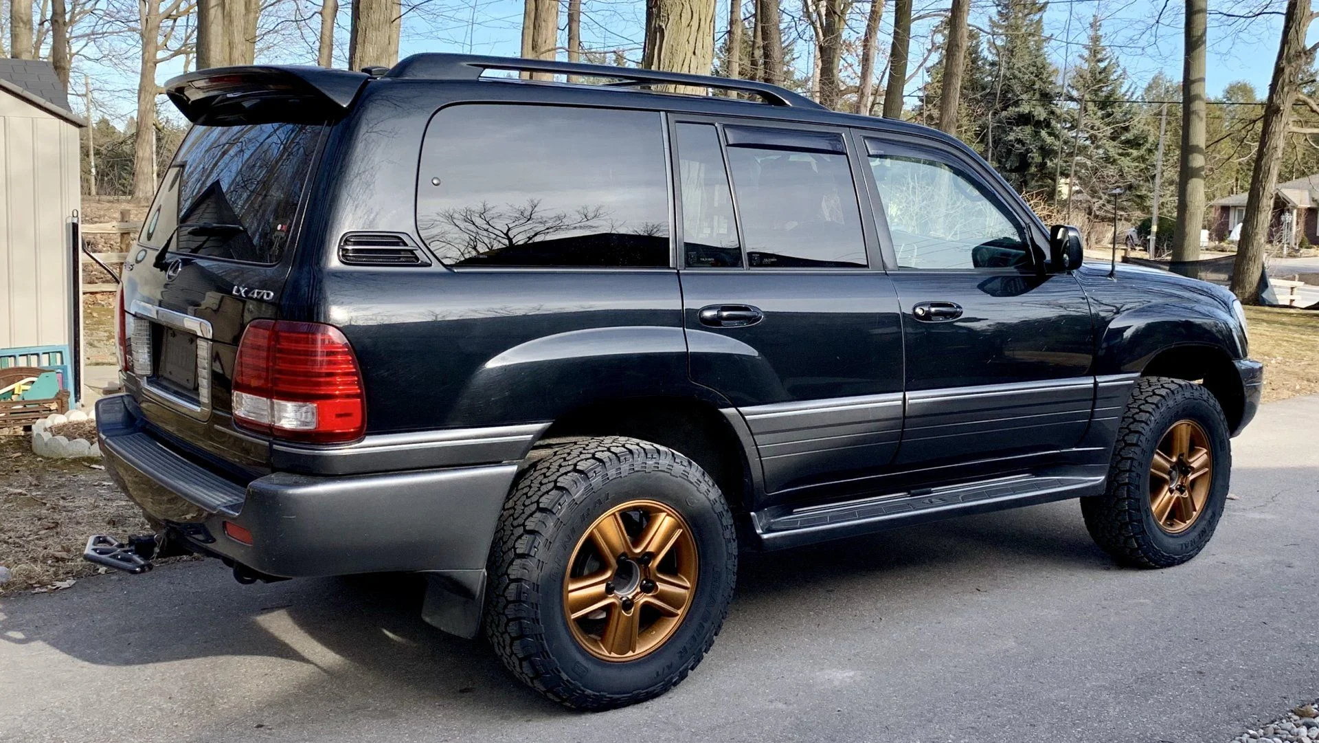

This guy does. I have heard mixed from various people. Some love it, others have said don't waste your time with icon. I am a set it and forget it person. So I went OME Heavies because they were local and I know I will eventually have weight.
Builds - Ikarus' LX470 Offroad Build
